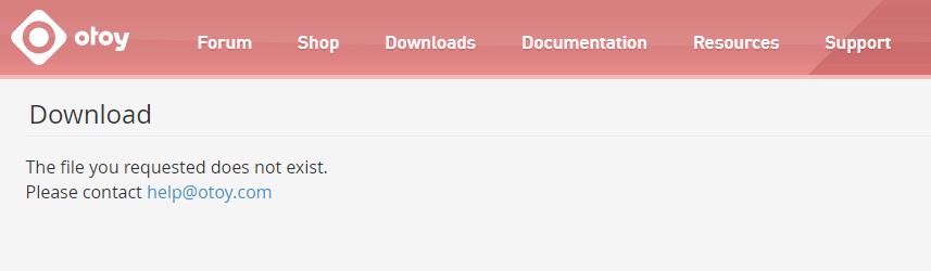

I can't download Enterprise R3... am I missing something?

Kalua wrote:I can't download Enterprise R3... am I missing something?
File was deleted by mistake, replaced it again. Sorry for that!
