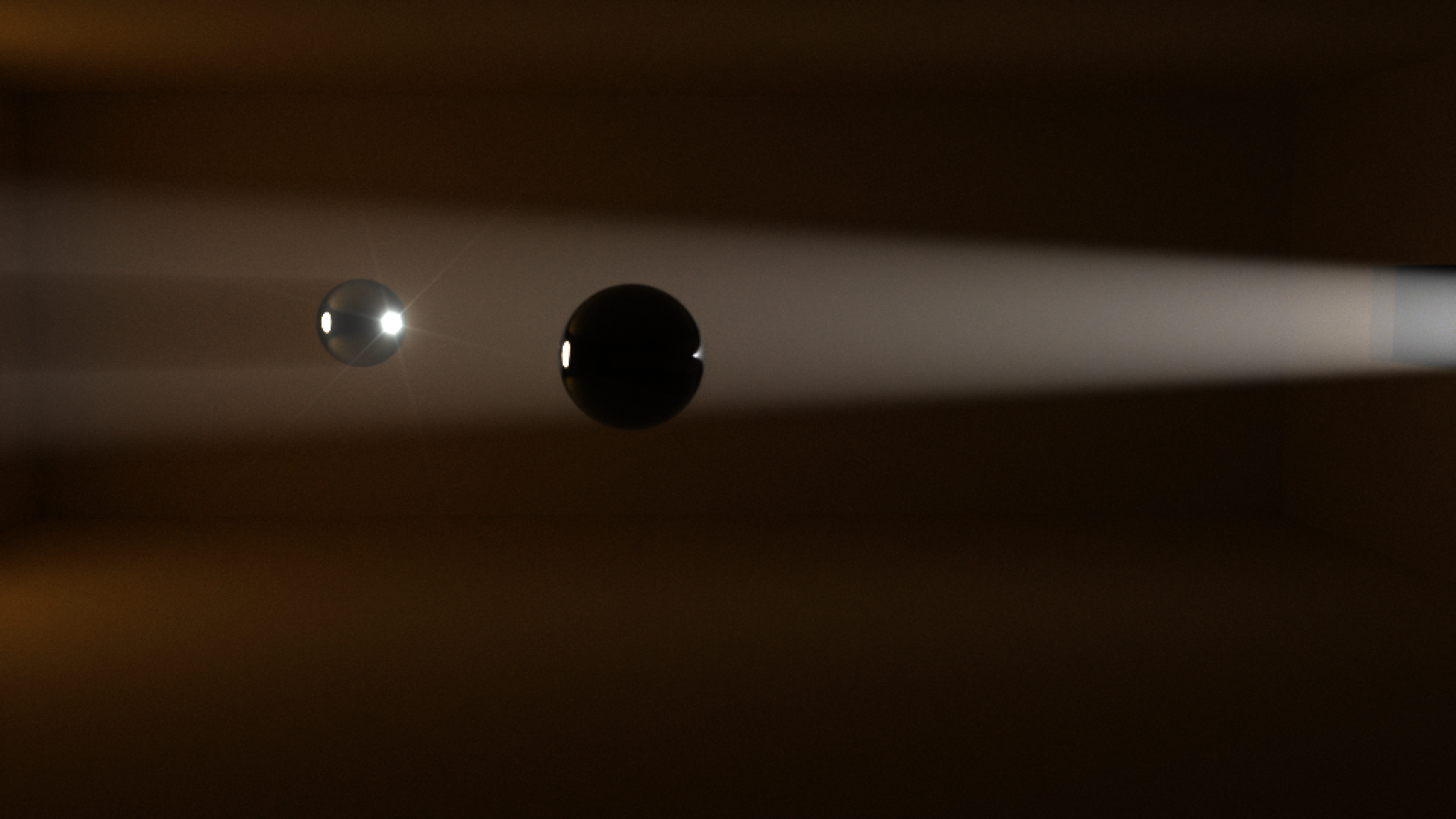

So this is what I'm getting using the 'fog medium' approach with a standard Octane light:
As you can see, the light distribution is even from left to right.

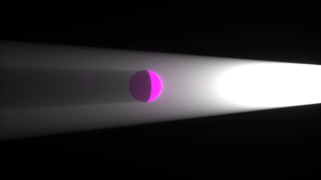

Now, when I'm using a Spectron Volumetric Spotlight at exactly the same distance from the object, I get a different result:
The right side - which is closer to the light - is completely blown out. I've dragged sliders around for about half an hour now, but I can't seem to be able to reduce the power of the spotlight and make the distribution more even.
Any idea, how this could be achieved? Thanks for letting me know.

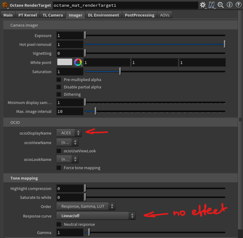

However, just to be sure we're on the same page regarding the overbright Spectron Volumetric Spotlight, I wanted to mention that my system in general and Houdini in particular are already set up to use ACES, which is why everything should be displaying properly (Octane Render doesn't even show any changes when I change the response curve, as the ACES/OCIO setting overrules everything else). So whatever I'm seeing is already taking into account that nothing should be 'clipped'.
There is something that doesn't seem to be working right, when using the Spectron Spotlight. The main issue is that you don't see the light ray unless you crank up the 'Throw Distance' enough so that it actually reaches the object and is visible from your respective camera angle. Whenever you increase the Throw Distance however, you loose power, so the light gets dimmer and dimmer. You therefore have to increase the light's "Power" to crazy high levels, what then again means that everything blows out. However, the falloff from left to right across the frame is really a tad extreme.
I checked this also as an EXR export and the issue inside an ACES comp pipeline is still the same. The way the image looks is as if the light was positioned just off frame on the right. In that case you would have an incredibly dramatic falloff in terms of brightness. However, the light is positioned around 5 metres to the side, so the falloff should really be a lot softer. The thing is, the further away I put the spotlight (to reduce the high contrast falloff), the more I have to crank up the Throw Distance, resulting in a high contrast yet again... :D

Ferdinand13 wrote:Octane Render doesn't even show any changes when I change the response curve, as the ACES/OCIO setting overrules everything else
That is to be expected. OCIO basically takes over the other color-management sections of Octane.
I remember replying to a similar topic in, if I'm not mistaken, this thread: https://render.otoy.com/forum/viewtopic.php?f=88&t=78025&p=403089#p403089

I am not able to reproduce it. Here is a screenshot with some scene information included:
