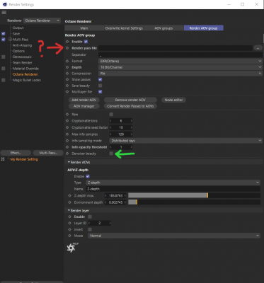

Is this the checkbox you are talking about (with the green arrow)?
By the way, while we are at it, there is something that has been confusing me. What is the render pass file? Should I leave it blank? (Red Arrow)

Yes it's for activating the denoised beauty pass. Render pass is old concept that's now renamed as render AOVs after we added AOV feature. You should use this and/or also "use denoised beauty pass" in main render settings. It will copy denoised beauty pass in to main buffer without selecting the render AOVs(aka old render passes).
