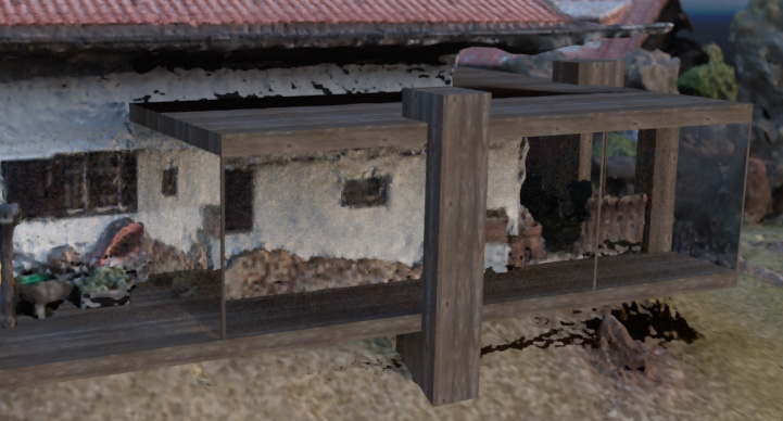

Glass refraction doesn`t work correctly
Postby Blum-Architekten » Wed Mar 30, 2022 7:17 am
Blum-Architekten Wed Mar 30, 2022 7:17 am
we have a problem with glass material (specular metarial). Although the geometry is only 1cm thick, it is rendered, as if the pane was perhaps a meter thick. Even if I set the refraction to 1.0, a strong refraction is calculated.
Installed is Rhino 7 SR 16
Octane Studio driver 2012.1.3.131
Graficcard RTX 2080 Ti
Driver Nvidia 512.15 studio driver
I would be very grateful for a quick help!
Blum-Architekten
Posts: 5
Joined: Mon Apr 20, 2020 10:29 am
Re: Glass refraction doesn`t work correctly
Postby face_off » Wed Mar 30, 2022 8:17 am
face_off Wed Mar 30, 2022 8:17 am
Blum-Architekten wrote:we have a problem with glass material (specular metarial). Although the geometry is only 1cm thick, it is rendered, as if the pane was perhaps a meter thick. Even if I set the refraction to 1.0, a strong refraction is calculated.
Hi. Perhaps double check that your scene units are correct (should be in metres). Also check that your kernel->ray epsilon is correct.
