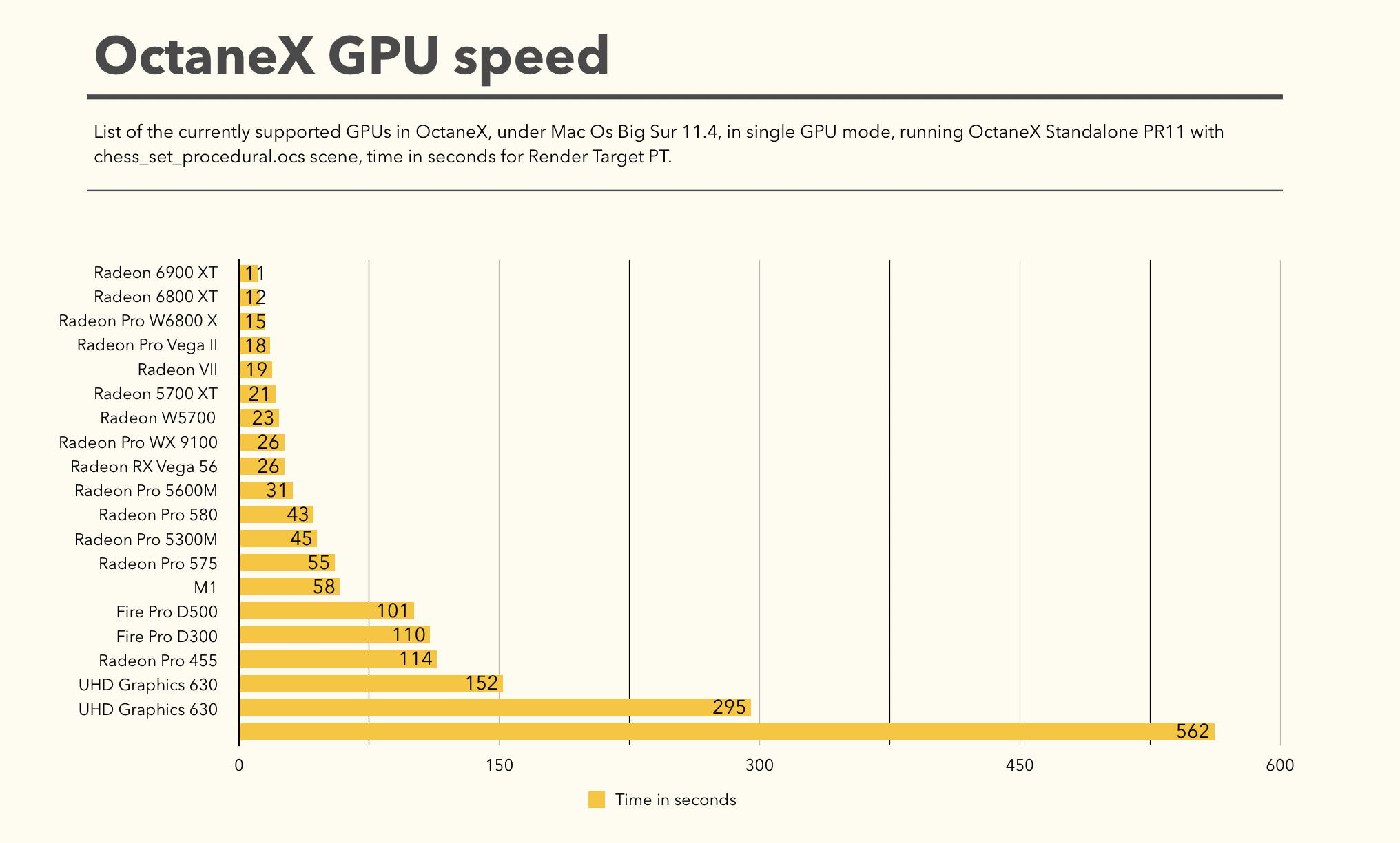

swienty13 wrote:So has anyone tested 6800 xt egpu with MacBook pro and can share some insights on render times? I heard thunderbolt 3 is bottleneck here...
Maybe for other tasks, but not for GPU rendering.
TB3 is slightly slower when loading the scene on GPU, but after few seconds, when the scene is completely loaded into GPU VRAM, the rendering speed is exactly the same as an internal GPU.
So the speeds that you can see here are real, even under TB3 eGPU:
ciao
Beppe
