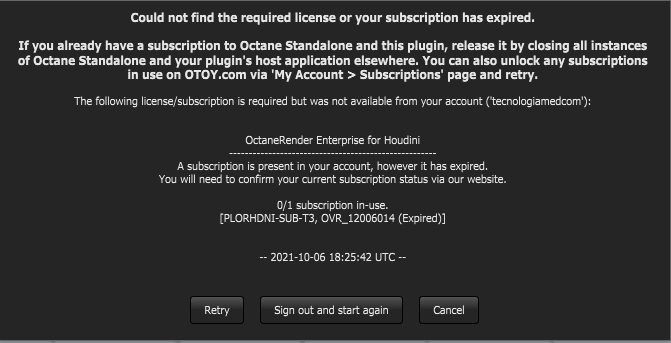

Hello @juanjgon I am trying to use the Houdini plug-in, but it shows that I have an expired subscription, that is because it is trying to access the studio subscription but I have another annual enterprise subscription active in the same account, but it seems that not knows it exists. The plug-in I use is the enterprise version18.5.672
Thx.

raulofs wrote:Hello @juanjgon I am trying to use the Houdini plug-in, but it shows that I have an expired subscription, that is because it is trying to access the studio subscription but I have another annual enterprise subscription active in the same account, but it seems that not knows it exists. The plug-in I use is the enterprise version18.5.672
Thx.
Is your available (not expired) license Enterprise or Studio? If your license is a Studio one, you need to install the Studio plugin build.

@juanjgon My not expired license is Enterprise and I installed the Enterprise plugin, but it shows that I have the studio license expired.
The Enterprise plugin reads the studio license that I have expired, but it cannot read the Enterprise that is active.

raulofs wrote:@juanjgon My not expired license is Enterprise and I installed the Enterprise plugin, but it shows that I have the studio license expired.
Can you please send an email about this issue to the support team? They have access to the licensing system to check what could be your problem. [email protected]

@juanjgon I have sent two emails and no one answers about my problem.

raulofs wrote:@juanjgon I have sent two emails and no one answers about my problem.
Be aware that the support team is located in New Zealand, so probably they will take a look at it next Sunday (European or USA time)
You can also submit a request here https://help.otoy.com/hc/en-us/requests/new or mail them at [email protected] They are pretty quick at answering tickets but as Juanjgon said, the weekend is coming up so they are probably gonna answer it on the next first work day.
