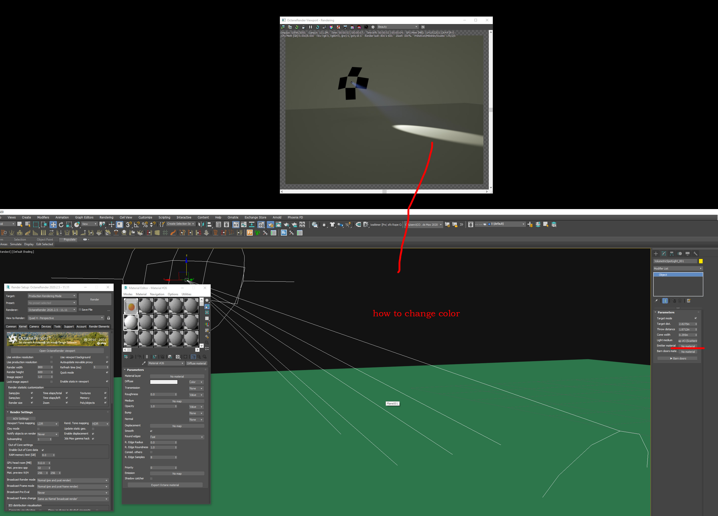

Hi Paride,
How do I change light color? How do you adjust spot brightness? When I add diffuse with emission to emitter material my small spot light disappears and the whole floor has light . Thanks

Also when I set volume to red light becomes opposite color

Postby paride4331 » Mon Sep 13, 2021 8:33 am
paride4331 Mon Sep 13, 2021 8:33 am
Hi coilbook,
I hope it helps.
Regards
Paride
vollight.zip
(84.6 KiB) Downloaded 106 times

Thanks. Do you know if octane uses real volume lights or it's some fake 3d cone with scattering material? Why do CPU renders have a vast varieties of volumetric lights and GPU are so weak at it? Thanks
Hi coilbook,
it's a 3d cone with scattering material; alternatively you could use a "classic" fog cube.
viewtopic.php?f=27&t=59549&p=304625&hilit=fog#p304633
New coming Octane features should also help in this way.
