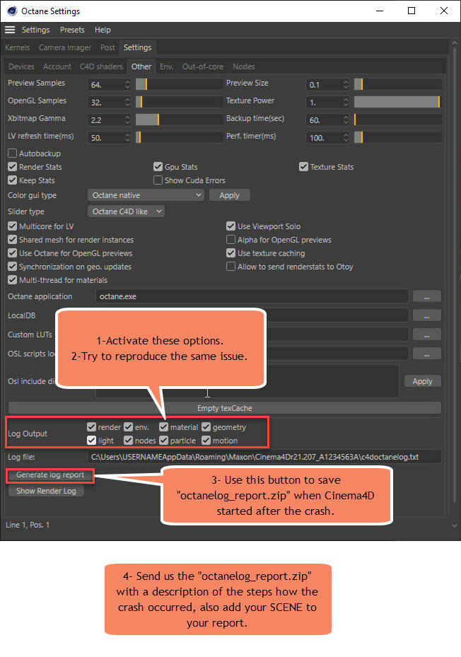

I have always some Octane windows+icons in startup layout. Even tried with custom layout with Octane stuff. It never happened to me. Send me your layout files and also make a report with the procedures as in picture.

Thanks for the reply, unfortunately Cinema4D crashes along with Octane and resets those tickboxes so I'm not sure I can save a comprehensive log file.
