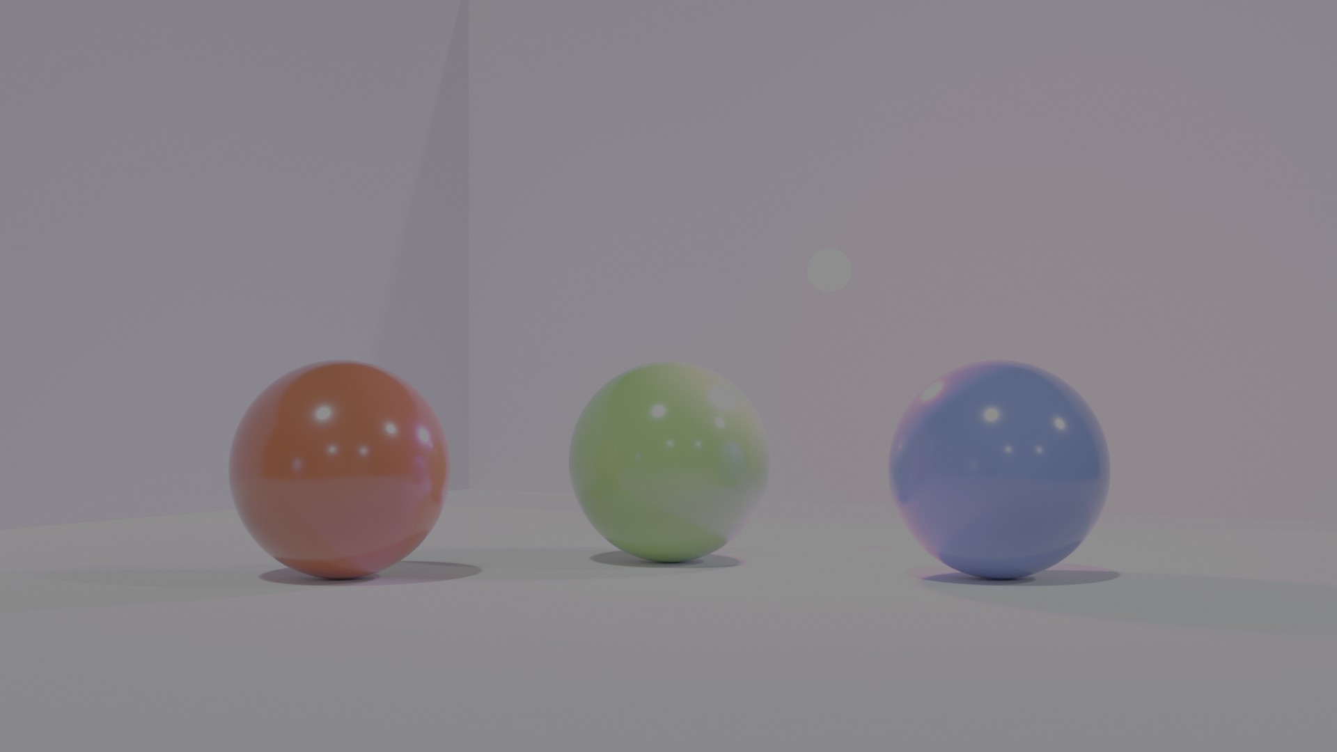

So in the end I ended up doing a comparison of ACES to filmic because what I realized is another setting was affecting how it looks out of the box, but I did a lot of tests just to compare.
Linear
Linear False Color
OCIO 1 Filmic
OCIO 1 Filmic False Color
OCIO 2 sRGB LOG
OCIO 2 sRGB LOG False Color
OCIO 2 ACES SDR Video
OCIO 2 ACES SDR Video False Color
OCIO 2 sRGB Un Tone Mapped
OCIO 2 sRGB Un Tone Mapped False Color
I am not entirely sure which if any of these I would actually like to integrate full time. To be completely honest, I am not overwhelmingly impressed with anything except maybe SDR video but the highlights worry me a bit on all of these except filmic. If you look at the gradient from highlight to shadow in the false color you will see what I mean. I dont feel like its actually packing more data into a smaller spectrum of values... I feel like its packing maybe a small bit more data in and then clipping off the rest. You can see from the large block of yellow with no real gradient followed by a short gradient in the light falloffs. Something just feels wrong about the curve, but I also havent tried any of them in an editor to compare how they edit. I am making this statement purely on my visual analysis I feel as though there must be some info out there on what kind of workflow to integrate with this.
All these images look abnormal and technically wrong, besides the unclamped ones.
The issue is unreleated to OCIO, Filmic or ACES. Remember that for Filmic OCIO by Troy.S to work properly, you need a linear-sRGB scene-referred 16-bit beauty unclamped OpenEXR file. I explain this part in the following link: https://www.elsksa.me/blog/octane-render-color-management
