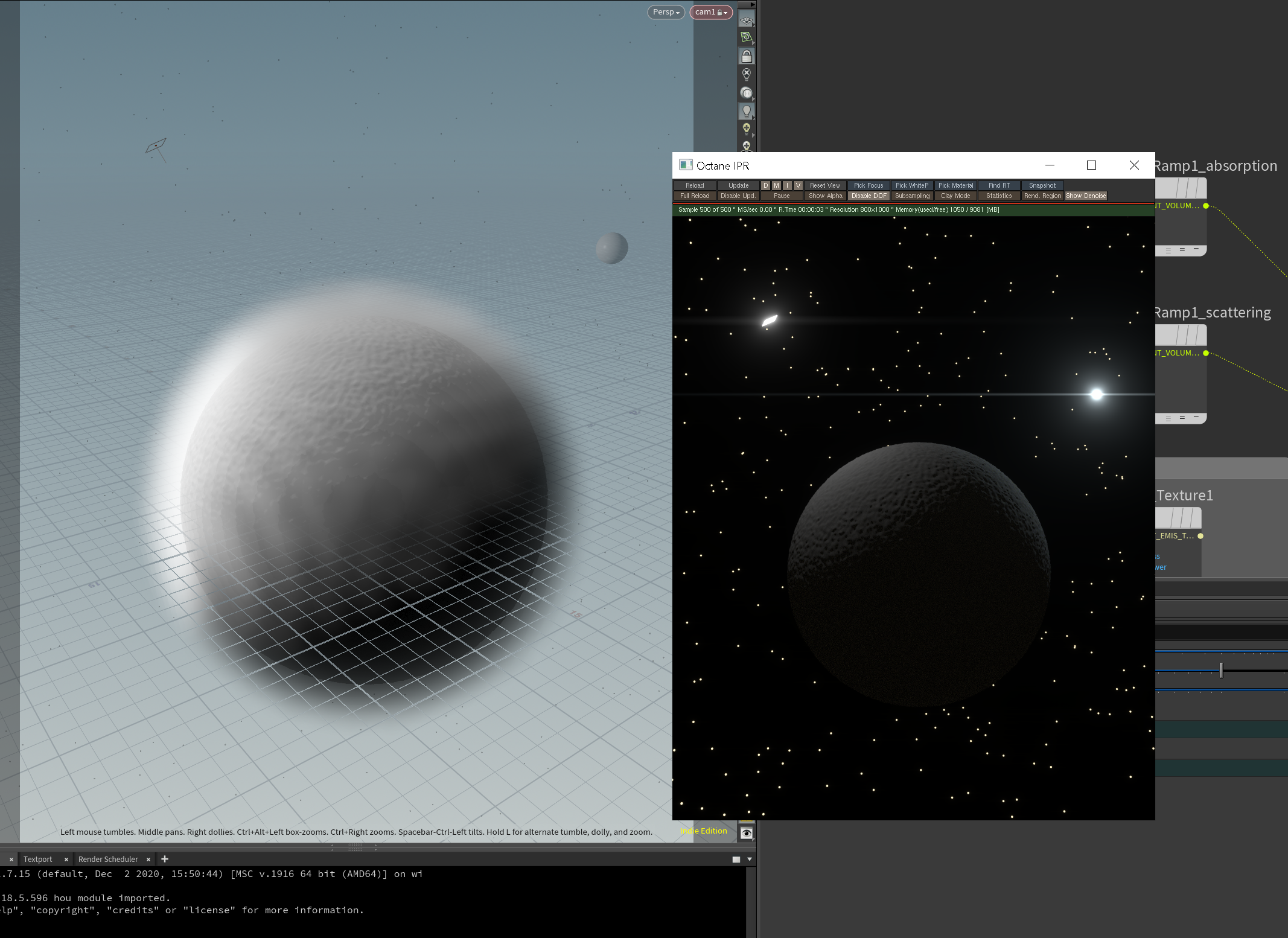

So I made a spherical isosurface volume to create a planet atmosphere, set it to Octane Volumes, and then used an Octane Volume Medium as follows, but it is not showing up:
Help is appreciated and thank you

Did you give it a name. In the isooffset node you’ll have to name it density because the isooffset doesn’t do it automatically.

Thank you Rohan that worked, naming the isooffset to density. I guess this is the only way currently to do atmospherics for now I am guessing. Now I have to figure out how to do a falloff from the surface haha. By the way I bought your Octane volumetric series, thank you so much they are very helpful.

For a falloff from centre outwards, Create a sphere. Use a points from volume. Then create a gradient from the centre out, you can make one using an attribute transfer. Set your point color to black, keep a white object in the centre and transfer the color attribute and set the distance to fade out the color. Copy the color to an attribute called density. The use a node called "volume rasterize attribute" and type density. It will turn your points into a volume and use the density values on the points to set the density of the volume.
