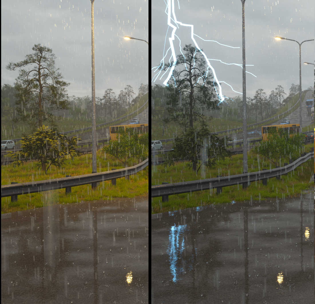

Postby coilbook » Sun Sep 20, 2020 4:06 am
coilbook Sun Sep 20, 2020 4:06 am
tcheng00 wrote:I could take a look at the scene. Can you share this scene?
Thank you for your help! I 'll try to compile the scene it's pretty big. Here is the example. The lightning is a mesh with 100000 samples and when it's on light posts don't shine on the ground anymore. Their samples are set at 200. The lightning was set at 10k to reduce the noise. I am not sure what's the best solution here I hope otoy can fix it where one light won't steal all sample from another. They need to create a system where light is still there for other light sources with less samples
