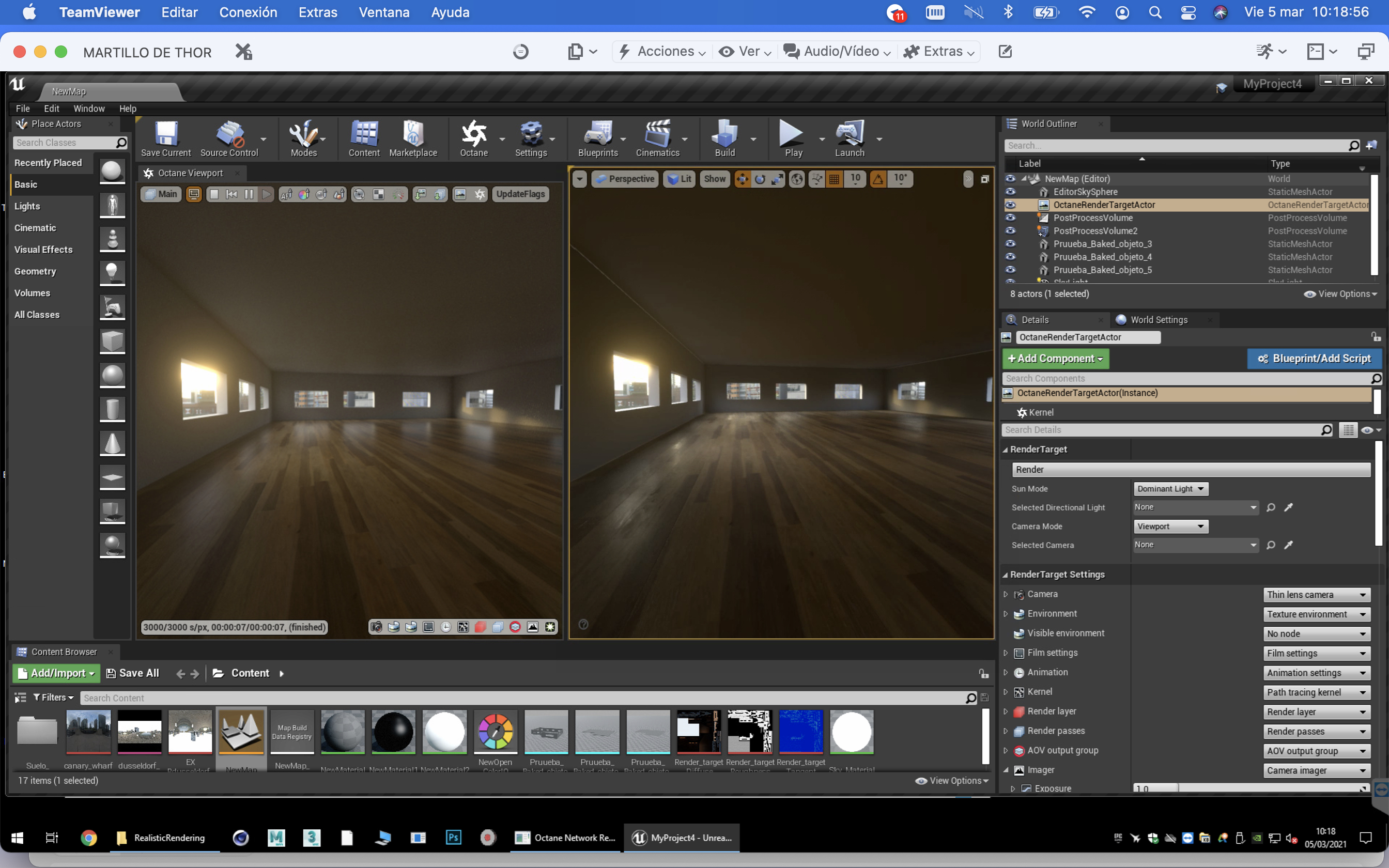

Hello Chris
Please implement Lightmaps baking inside UE4, tested GPU Lightmass against Octane Render, and it is still very bad.
1-No Multi-GPU support = Still very slow if it is needed to reach production quality.
2-No Unbiased Render = Need a very time consuming tweaking to get photo-real results.
3-Very poor control of render engine parameters = Can't adjust quality to projects needs.
4-Lot's of render artifacts = There are lots of artifacts very difficult to find workaround and hacks
5-Needs a difficult to find artist to get hyper realistic results = It need a very experienced artist to know all the tricks, cheats, hacks, workarounds to get photo real result.
6-Problems of color workflow = Even using UE4 OCIO support, still lots of problems to get color consistence to render the UE4 project for color grading.
7-Since there is no Multi-GPU support, cant take advantage of GPU Render Farms.
8-Checked the load for GPU, it's not optimized, working only at 50%.
9-Bad 3d Scene interoperability. Even with USD is only intended for import, lack a ORBX scene approach to share the scene between different DCC tools.
10-Lots of problems supporting big big texture maps such 32K or higher = With octane you can support big texture maps without problems even with DDS compression.
I truly believe there is a good opportunity for Octane Render as an alternate Render Engine for UE4, even more if we take into account the growth of virtual production.

Thanks for the write-up. Ive checked it out myself and mostly concur with your opinion here.
Is this only with GPU lightmass? or is this a general issue with lightmass and lightmapping in unreal?
