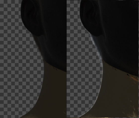

I also have a problem with unpremultiplied alpha with the denoised render. This problem is also in 2020.1.
This is the most noticeable with hair. I attached a screenshot. Left is not denoised (unpremultiplied) and right is denoised (also unpremultiplied). As you can see the right one is a bit brighter on the edges.

galleon27 wrote:Its somewhat fixed. Still doesn't render properly. The color is just off when Denoiser is on.
It seems like you have enabled the raw pass that is causing this under beauty pass. Looking at the results, it seems like they are expected provided you multiply the reflection indirect pass to the reflection filter pass (using linear workflow), you will get the same reflection indirect result as disabling raw pass.
If you disable the raw pass in your beauty pass, you should get the expected result.
As for the alpha issue, we are investigating that currently.

That was indeed the case. Raw pass was enabled. Works as expected when disabling.
Thanks for the help Wallace.
