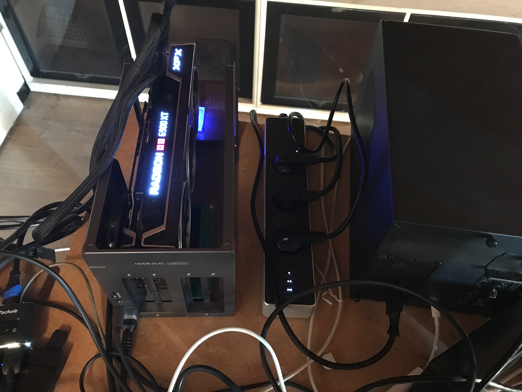

Here is an AMD 6900 XT in Akitio eGPU box, connected to Mac Mini 2018 Thunderbolt 3, with Big Sur 11.4beta3:
It works great :D
ciao Beppe

Whats the PSU on thT chassis?
iI have a breakaway box 550....but don't think it will handle a 6800 or 6900
cjadams
Posts: 210
Joined: Sun Oct 18, 2015 2:27 pm
Re: Octane X on iMac / which eGPU?
Postby bepeg4d » Mon May 17, 2021 8:19 am
bepeg4d Mon May 17, 2021 8:19 am
the PSU is a 550W and seems to handle it very well, so also the Sonnet breakaway box should be able to handle it, it is exactly on the right in the picture… the issue is how to fit the beast inside it… it is huge :shock:
Since I’m currently losing one slot of my Akitio Duo, I have to place the 6900 inside the Sonnet me too, but I have to figure out how to correctly do it :D
Let me know if you find a clean solution.
ciao Beppe
