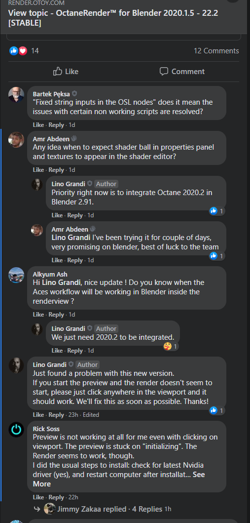

I think on one of facebook posts he mentioned he wanted to hear from those with newer rtx cards.

Funny that they use facebook rather than their own forum.
