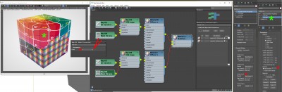

Hi Drigg,
I hope it helps.
Regards
Paride
I hope it helps.
Regards
Paride

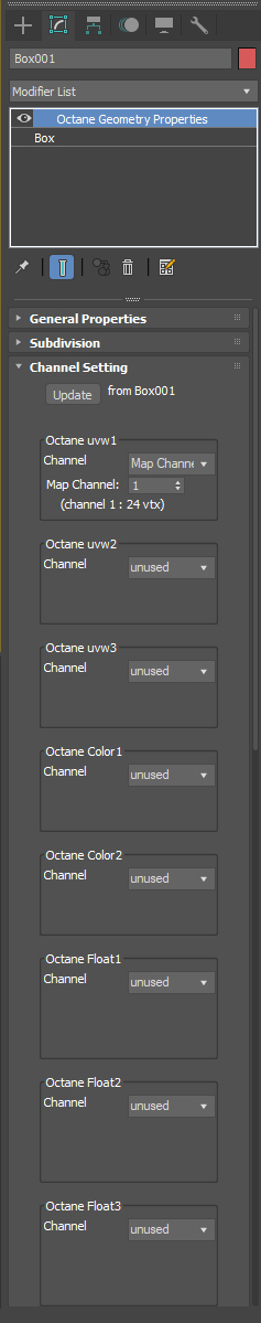

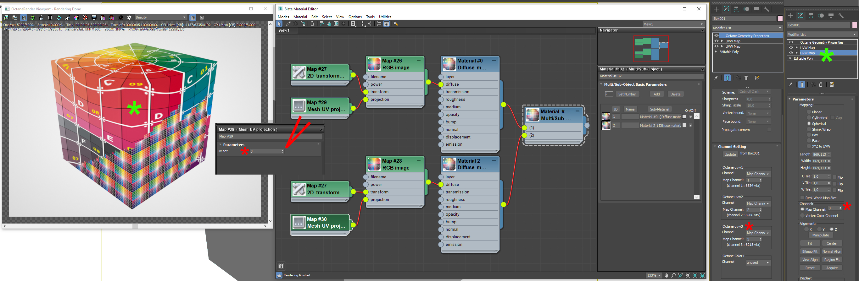

Hi Drigg,
3dsmax 2020 version here.
Regards
Regards

Thnaks again,
When i open you file i see this..
Thats strange in the viewport i can see your texturemaps, but the material is empty. if i start the octane renderview the cube is white.
btw. i have the following demo version: OctaneRender 2018. 1.2 - 7.06 Demo.
best,
drigg
best,
drigg
