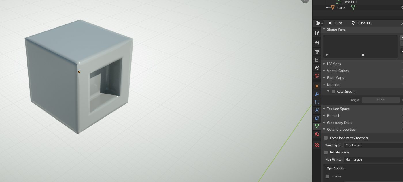

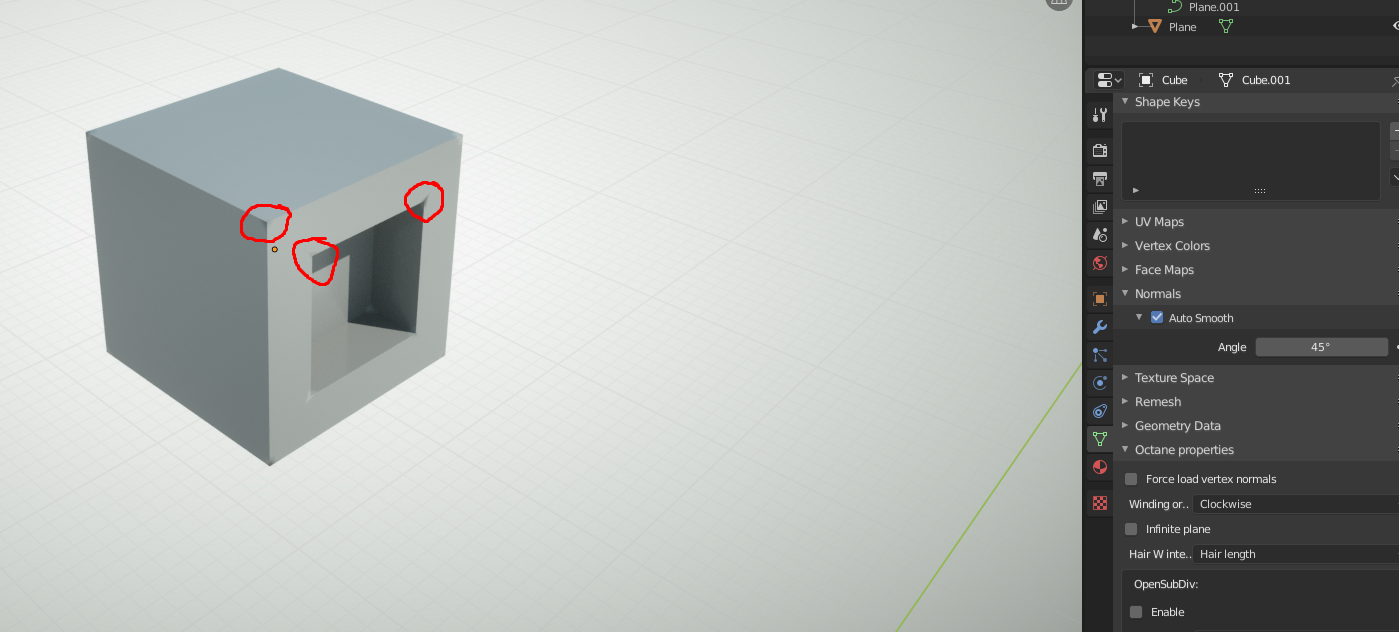

I am facing some issues with the Rounded Edge feature. Any idea why it looks like this?
Blender 8.1, OctaneRender_Enterprise_2019_1_5_win, OctaneServer_Studio_2019.1.5_20.7_stable. GeForce RTX 2070 newest driver.
[SOLVED] Rounded Edge with the Universal Material
What's the scale of your objects? If they are very small, a rounding radius of 1 may be the problem. Remember that this is just a rendering trick with normals, not any actual geometry modification. I've also seen similar render glitches with the Octane edge rounding option when vertex or face normals were out of whack on certain objects, particularly primitives. One quick-n-dirty work around was exporting the geometry as .obj then re-importing.
Hello,Chimera wrote:I am facing some issues with the Rounded Edge feature. Any idea why it looks like this?
have you used Accurate mode in Round edge node? Fast mode give such artifacts as on your screenshot.
