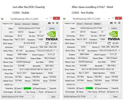

Postby yazganarikan » Mon Feb 10, 2020 10:11 am
yazganarikan Mon Feb 10, 2020 10:11 am
Hello Beppe,
Thank you for the instructions,
1. I installed windows 8 version of 419.67 since my OS is W8.1
2. I performed a clean installation
3. I still see the same error in Octane 4.05
This is my GPU-Z screenshot. I see that CUDA is not marked after 419.67. ( please note that just after the DDU, I was able to see CUDA ).

Re: OCTANE. No CUDA GPUs Error.
Postby bepeg4d » Tue Feb 11, 2020 7:50 am
bepeg4d Tue Feb 11, 2020 7:50 am
please try to perform a clean installation of 442.19 driver:

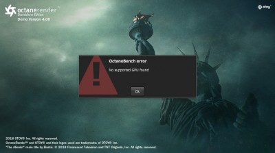

Postby yazganarikan » Tue Feb 11, 2020 6:28 pm
yazganarikan Tue Feb 11, 2020 6:28 pm
Hello
I clean-installed 442.19 for Windows 8.1
I ran OctaneBench_4_00c / octane.exe and received this message: No supported GPU found
Postby bepeg4d » Wed Feb 12, 2020 7:38 am
bepeg4d Wed Feb 12, 2020 7:38 am
Is CUDA still unchecked in the GPU-Z panel?
You need to find an Nvidia driver greater than 419.67 that works for you.
Unfortunately I don’t have other reports from Win 8.1 users, normally it is Win 7 or Win 10. :roll:

Postby yazganarikan » Wed Feb 12, 2020 12:39 pm
yazganarikan Wed Feb 12, 2020 12:39 pm
Yes CUDA is still unchecked in the GPU-Z
It is unfortunate that the problem still exists but thank you very much for your help Beppe!
