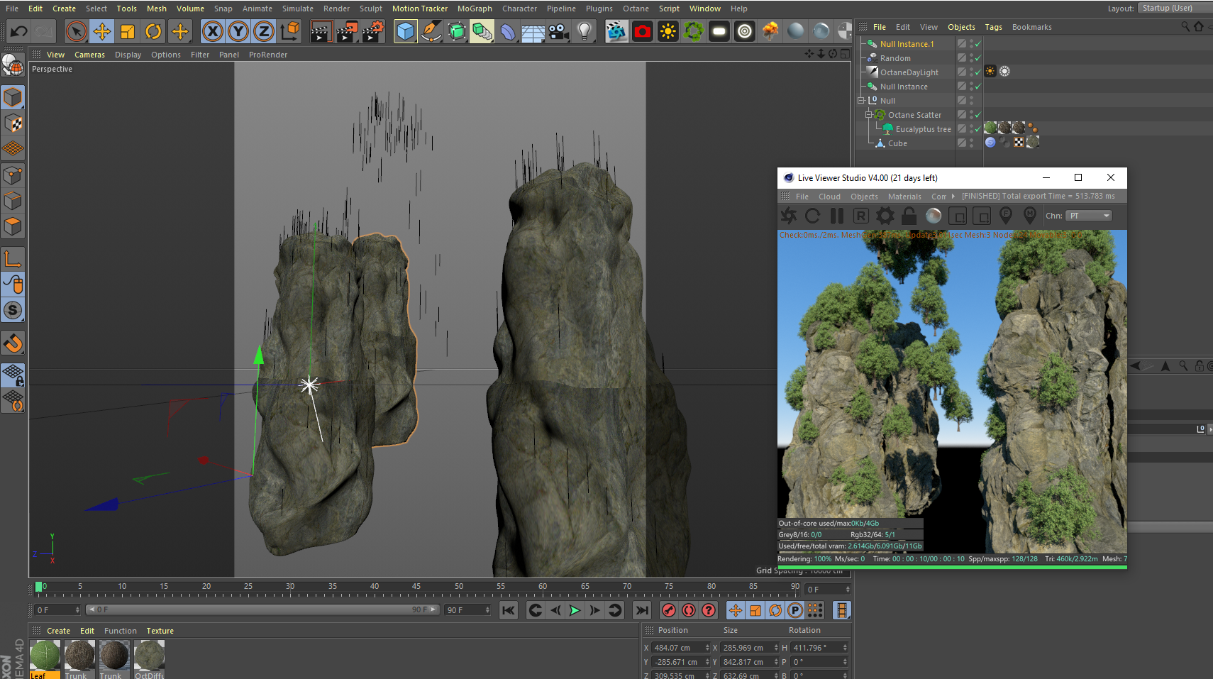

Hello, I was following this tutorial: https://youtu.be/etSTx4SJ6j4
I got stuck early on using instances with octane scatter . When I tried to move/copy/rotate the instance, the trees (forester) don't stick. Can someone guide me or point to a helpful tutorial about how to make the trees stick. I appreciate it!

It seems to be working fine, as demoed in the tutorial. I suggest you try it again, with very simple objects, to get a feel for the relationships. Try something like this:
Simple Scatter Tree Mountains
What you are describing is usually caused by accidentally transforming multiple levels of a hierarchy at once, instead of just manipulating the top level and letting the child object automatically inherit the transform. Be careful of exactly what you have selected when moving and rotating your instances.
