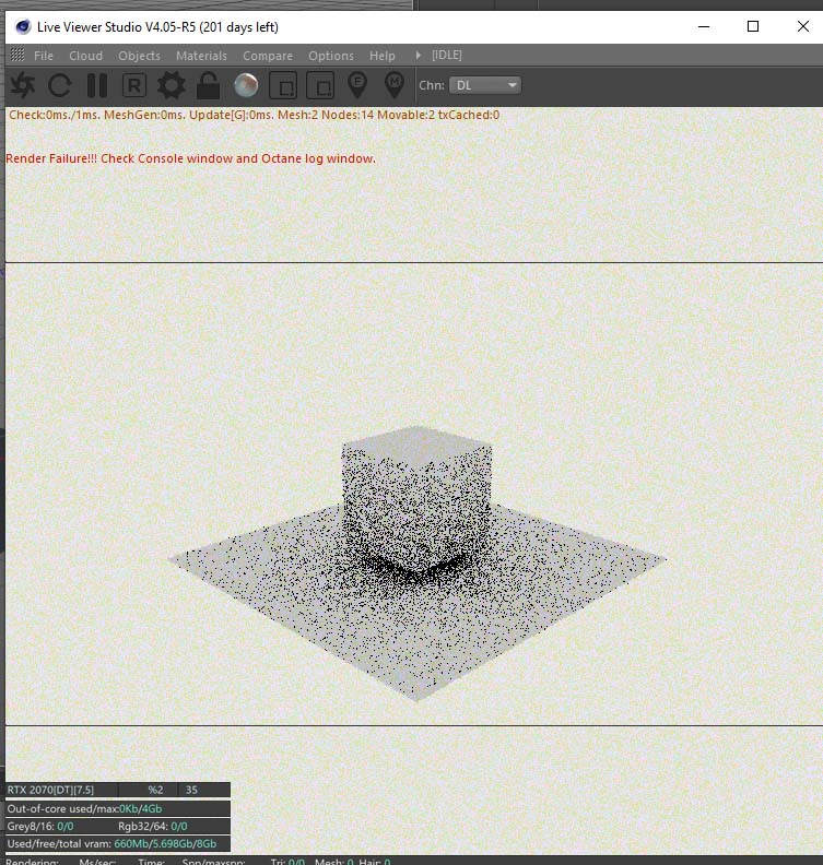

this is more info

Postby Alexisbaydoun » Mon Sep 23, 2019 5:43 am
Alexisbaydoun Mon Sep 23, 2019 5:43 am
Yes i can render a very basic scene I tried.
Regarding Nvidia number i'll check when i have access to computer, and temperature is attached in the GPU screenshot i posted: 33 degrees.

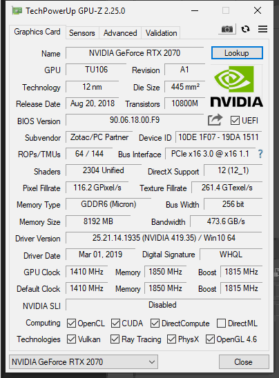

Postby Alexisbaydoun » Mon Sep 23, 2019 4:37 pm
Alexisbaydoun Mon Sep 23, 2019 4:37 pm
this is the nividia driver information

Postby aoktar » Mon Sep 23, 2019 4:38 pm
aoktar Mon Sep 23, 2019 4:38 pm
try latest Nvidia studio driver, 431.xx
