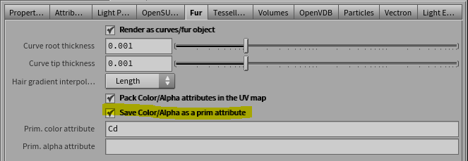

I use octane 2018, with the new Color Vertex Attribute node.
On a polygonal faceted object everything work as expected , i can access Cd as a point / vertex attribute
But when using a polygonal curves , i just can't make it work, i use the render as curves feature in Objparms fur tab.
=> so does the new feature work on curves object or not ? if not is this a houdini plugin restriction or an octane core restriction ?
When i use the old trick of storing Cd as a prim attributes, then activating Pack color in the UV map , and remap throw rgb4k_map.ppm it does works.
=> so does the old workflow is still the default workflow to render Cd attributes on curves with octane 2018 ?
I would need to export this workflow to octane standalone , problem is when i try to store manually @Cd as @uv at prim level it does render some color but not the good one.
So i guess that the feature of storing @Cd in the uv map is not as simple as copying Cd to UV. There must be some black box voodoo that i can't reproduce.
=> juanjo would it be possible to explain exactly how you store and remap @Cd in @uv and how to interpret it correctly throw rgb4k_map.ppm ?

Yes, sorry, the user attributes are not working in the curve objects yet. This feature is only available for the mesh objects currently.
I don't understand your second question. If you export a scene from Houdini to .orbx including the Cd attribute packed in the UV maps, it should be rendered by the Standalone without problems. As you say there is some math to encode the attribute into the UV map to reference the exact color from the .ppm file.

Sorry, this is an Octane render limitation. The custom attributes are only available for the mesh objects, but I suppose that this feature will be expanded to other geo types and the instances in the future.
I'll send you a PM with the maths behind the Cd to UVs attributes encoding.

- if i set rgb value to their @Cd equivalent and set alpha to 1. the color works perfectly with rgb4k_map.ppm.
- if i set rgb value to 0 and set alpha to @Alpha. the alpha works perfectly with alpha4k_map.ppm.
- BUT when i set rgb with @Cd AND alpha with @Alpha, the colors works but the alpha fail.

Ok juanjo i got it !
- primitive uv are not supported by octane
- in order to render curves Cd/Alpha you have implemented only one @uv channel that is able to store r,g,b,a inside only 2 channel @uv.x and @uv.y (which is really clever by the way)
- multiple uv set won't work at prim level
- ppm map must be interpreted as linear space map
