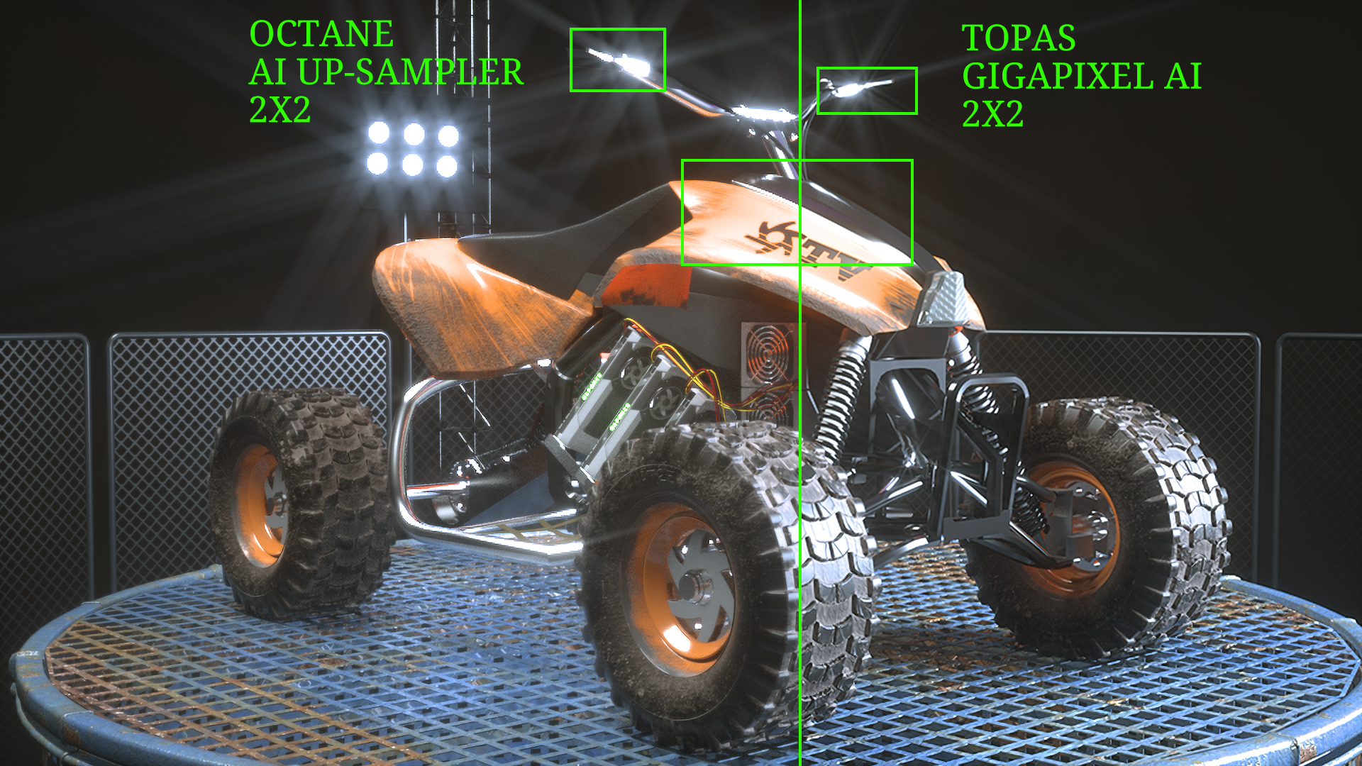

Are you going to improve AI Up-sampler? For now, it is not so perfect. Topas Gigapixel AI makes the job better for now.
And how to view AI Up-samplered image? I do not see any new pass.

ramone163 wrote:Are you going to improve AI Up-sampler? For now, it is not so perfect. Topas Gigapixel AI makes the job better for now.
Exactly what I saw, worst part about this is, I am going through this problem of jaggidy speculars on a project I am working on at this exact moment... But I am in V4.
