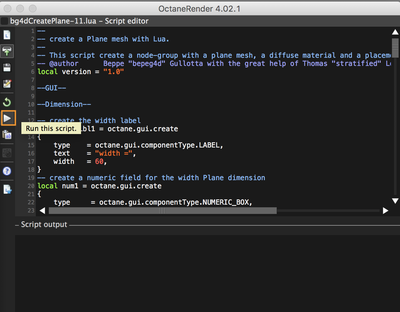

To use a Lua script you have two ways:
  • 1. Create the Script Editor window from the Windows menu:
    Then load the desired script with the proper icon:
    And press the Play button to run the script:

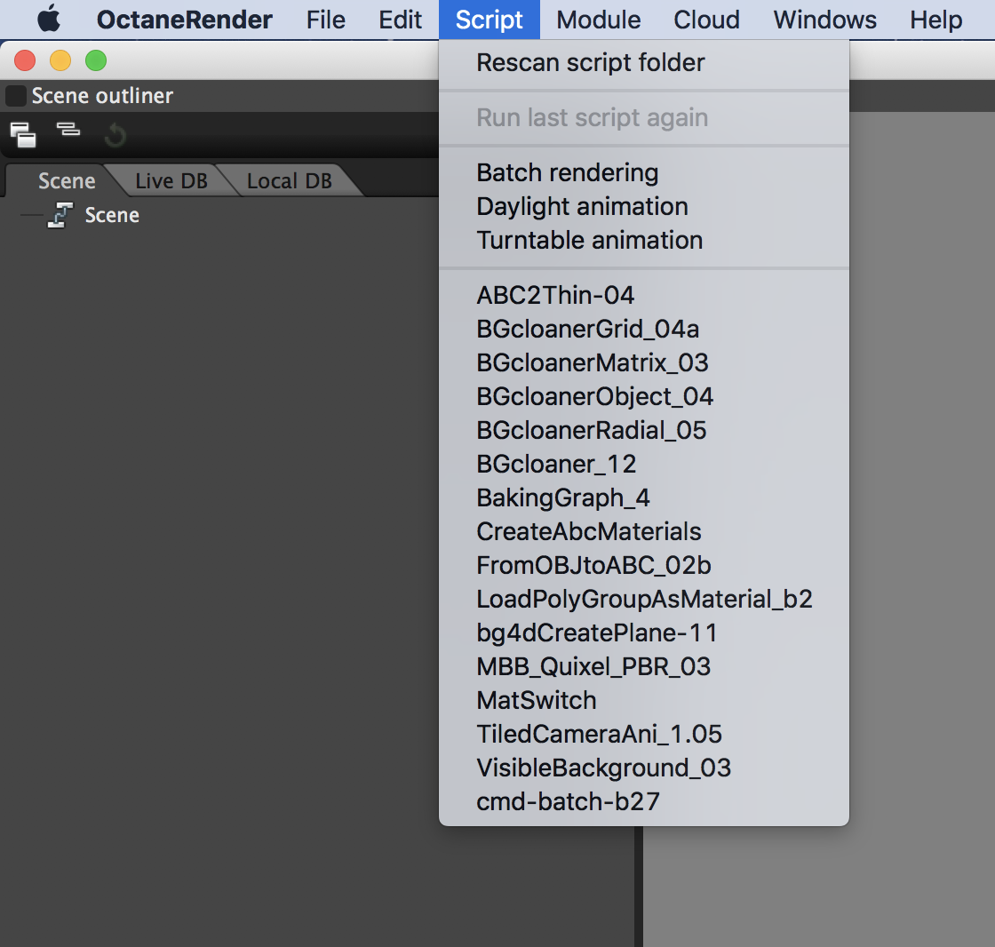

  • 2. Go to File/Preferences/Application, and specify a path to a folder with Lua scripts inside:
    To have them available directly from the Script menu, after restart, or rescan of the Script folder:
