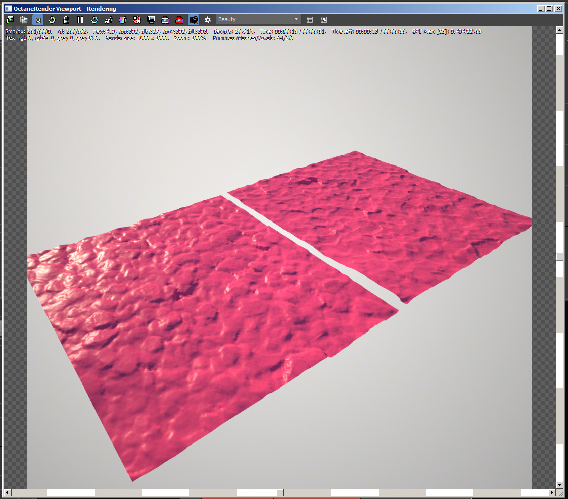

you can obtaine a correct texture into Octane but at the end you have to use a baking node so to speed up the process would be converting to grayscale in photoshop.
something as in this case: https://render.otoy.com/forum/viewtopic.php?f=30&t=56508&p=289968&hilit=+megascan#p289968
