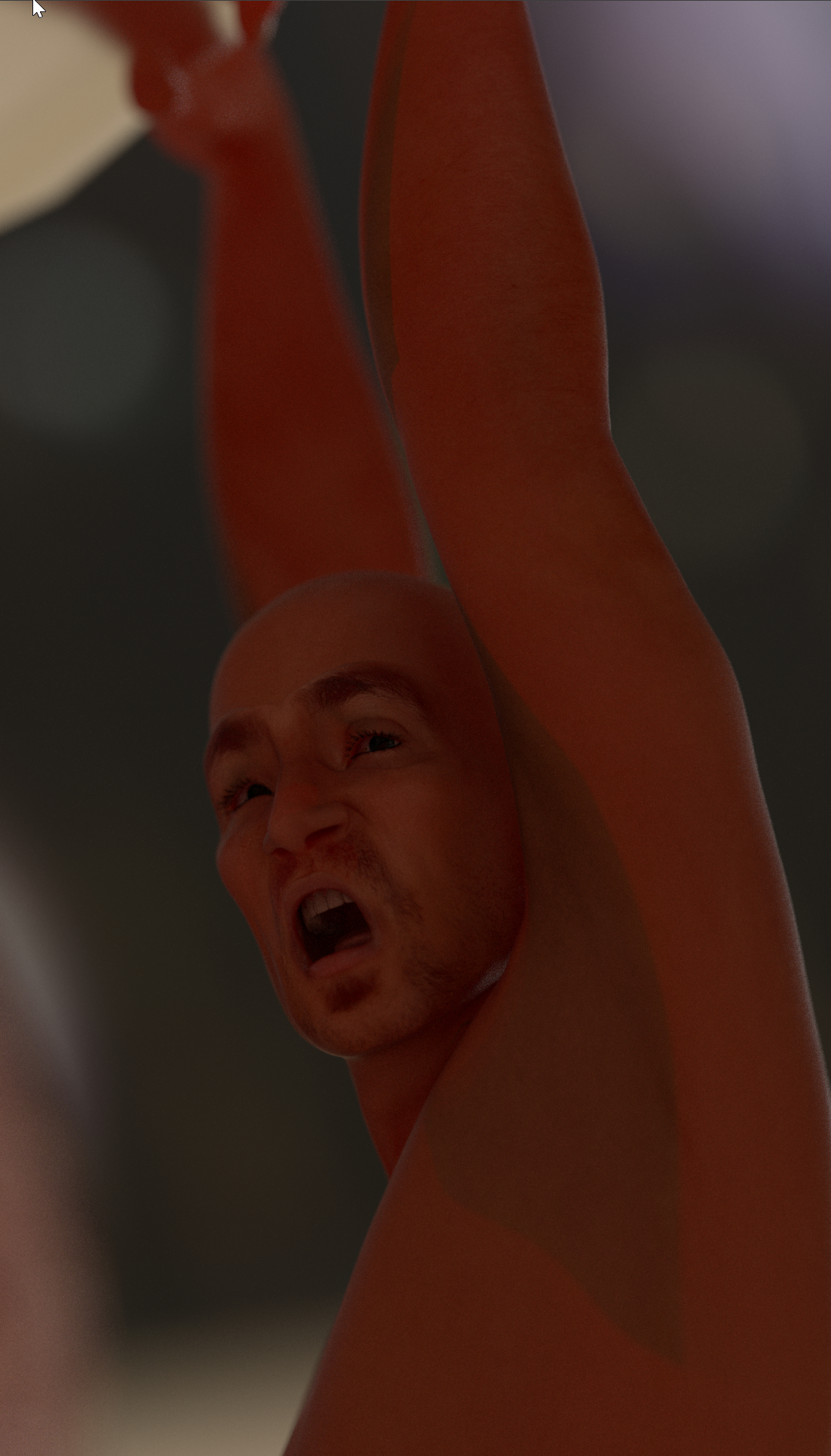

Any way to avoid this other than scaling up?
I tweaked ray epsilon, but at some point those strange self-shadows appear. can I tweak something within octane/materials to treat scaled-down/scaled up figures as if they were normally-sized?

face_off
Posts: 15822
Location: Adelaide, Australia
I think Poser figures should not be scaled down, otherwise the vertex density will be too high. Instead, scale everything else up. You can do this in the Settings with the Poser to Octane Scale Factor.

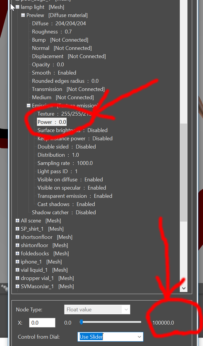

what i meant was: can I change the max cap value of an emmiter's power to be more than the 100000.0 max that is at the default? (for the sake of allowing me to scale up my scenes...I must scale the lightning power, and it grows exponential: if I scale up a scene *10, I need to scale up the light's power *100! and so on...)

face_off
Posts: 15822
100000 is the maximum emitter power that Octane will allow.
