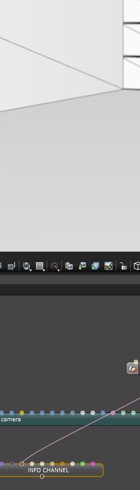

Hi guys,i have a problem with this version when I use the kernel infochannel.
When I use the infochannel kernel the sofa disappears from the scene
With other kernels it works correctly.
Path tracing
Info channel
