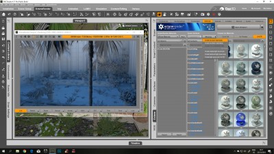

Step 1: Loaded the scene in MAN mode
loading the scene without materials
- allows you to test if the geometry loading triggers any errors
- makes sure that you do not exceed the available VRAM
Private Garden v1001 - Instancing not working

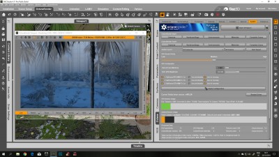

Step 2: Create auto materials
- this will allow you to test if material loading triggers any errors
- if the scene does not fit into VRAM try autoconverting one surface after the other
Private Garden v1002 - Create auto materials

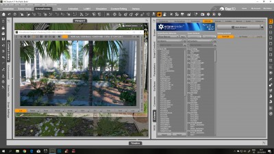

Scene loaded in Octane
Private Garden v1003 - Auto materials created

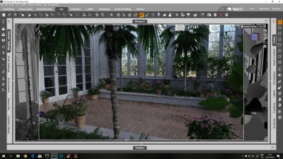

Original Scene in Iray
Private Garden v1004 - Iray version
