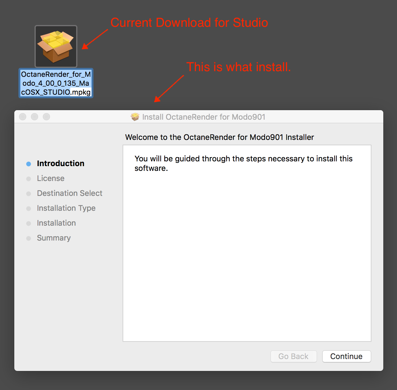

Postby lluistar » Fri Nov 02, 2018 8:26 am
lluistar Fri Nov 02, 2018 8:26 am
Looks like the current OSX Studio download link is actually the plugin for MODO 902 instead of the Studio app

Re: OctaneRender 3 for Modo [TEST and STABLE]
Postby face_off » Fri Nov 02, 2018 12:01 pm
face_off Fri Nov 02, 2018 12:01 pm
Which release number are you referring to please?
Postby lluistar » Mon Nov 05, 2018 7:12 am
lluistar Mon Nov 05, 2018 7:12 am
Face_off, please, see attached image.
