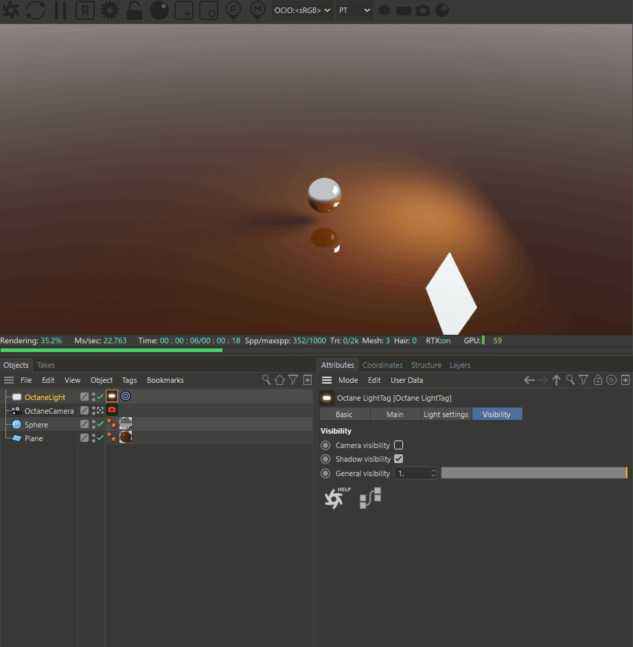

Postby geoyeo » Fri Sep 24, 2021 9:22 am
geoyeo Fri Sep 24, 2021 9:22 am
I understand the concept and of course it works like you described there is no doubt on that.
I am trying to avoid having the "square" reflection of light showing on the other objects. For eg on the sphere and on plane in this instance..
Is something like this possible?

Re: Invisible Lights still visible
Postby jayroth2020 » Fri Sep 24, 2021 6:12 pm
jayroth2020 Fri Sep 24, 2021 6:12 pm
You can try using a Rayswitch node with reflections disabled on the material, which will then not reflect the light. However, ALL of the reflections on that material will ALSO be ignored. Octane is physically accurate, and though there are some tricks here and there for some aspects, for the most part you need to manage situations like this in your scene and lighting design.
Postby funk » Fri Sep 24, 2021 6:46 pm
funk Fri Sep 24, 2021 6:46 pm
I don't use c4d, but one way to do this is to disable "visible to specular" on the texture emission node.
You'll need to find where that's done in c4d.
funk
Posts: 1204
Location: Australia
Postby aoktar » Fri Sep 24, 2021 9:54 pm
aoktar Fri Sep 24, 2021 9:54 pm
funk wrote:I don't use c4d, but one way to do this is to disable "visible to specular" on the texture emission node.
It's in light tags
Posts: 15969
