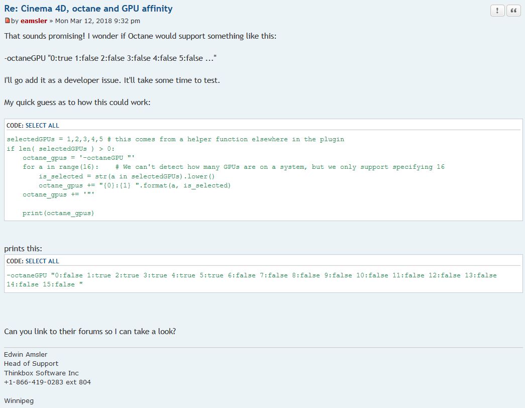

Forwarding again from thinkbox deadline forum:
Taking snapshot was easier so here it is. Makes sense?
