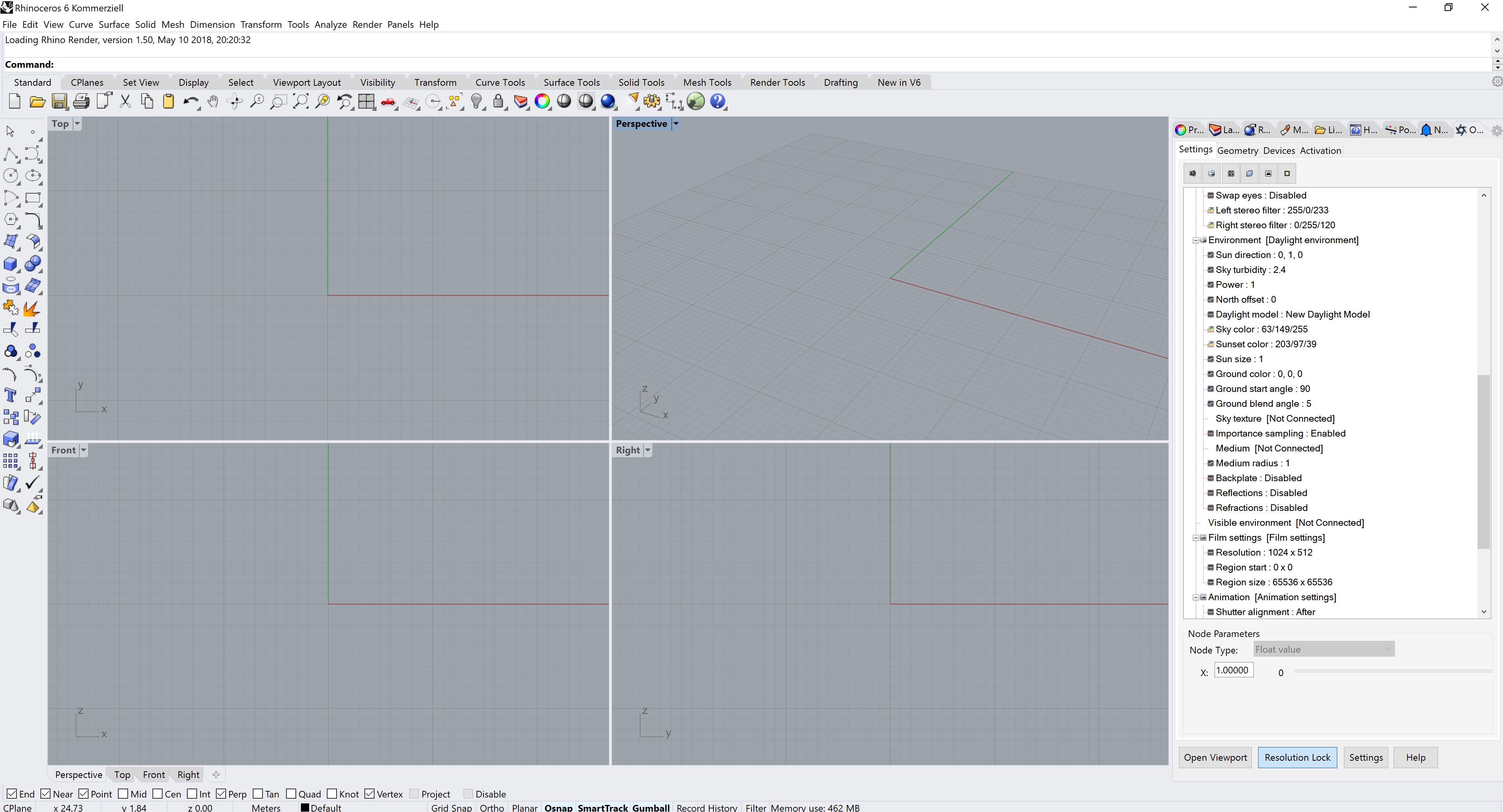

I just had to re-install Rhino V6 ((6.4.18124.12321, 05/04/18) and Octane (OctaneRenderForRhino6_3_08_0_91.rhi) and when I go to the octane tab I cannot even read the texts or any of teh pop-up menus or slides. Stuff looks like this:
I'm using a 4K monitor and my Nvidia card is Quadro M5000M. Driver 24.21.13.9764
Any Ideas what to do?
I don't have a 4k monitor, so hard for me to test this. But perhaps try adjusting your Windows font scaling.

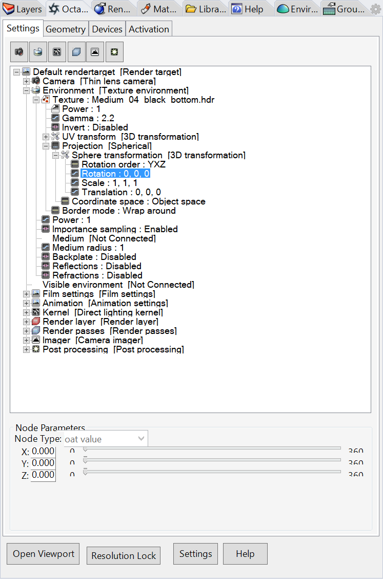

Hi Paul,
That solved most of. I had to swing my entire Windows scaling form 125% (my preferred size) to 150%. But now at least most of the Octane panel is visible, still some weird cropping happening (in pull down menus and in some of the sliders). this is not happening with any other panel or UI element in Rhino. Any chance you might be missing some High-DPI code from them to make things behave better?

Could you pls try this version, and tell me if it fixes the compressed Octane Material tree problem (post a screenshot pls)? It should also fix the issue where Material sliders are not working.

i tested the .92 version of the plugin.
the palette looks much nicer.
- when i first open the material palette, the slider and the number input both works fine.
- after a few actions, such as assign material to objects, switching to other software and come back to Rhino, the palette starts behaving as in the previous version again.

4k monitor win 10 rhino 6.4.18130.19341 octane 3.08.0.92
still the same problem. hard to read.

McNeel has provided a solution for this issue. However I have not been about to source a 4k monitor which works with my hardware. So I suggest if there is one user willing to test out experimental versions of the plugin, I can work with them (via Skype) and resolve this issue. Any takers?

Can you pls try the TEST release 3.08.1.92 and tell me if it fixes your issues.

Hi Paul
looks good now.
