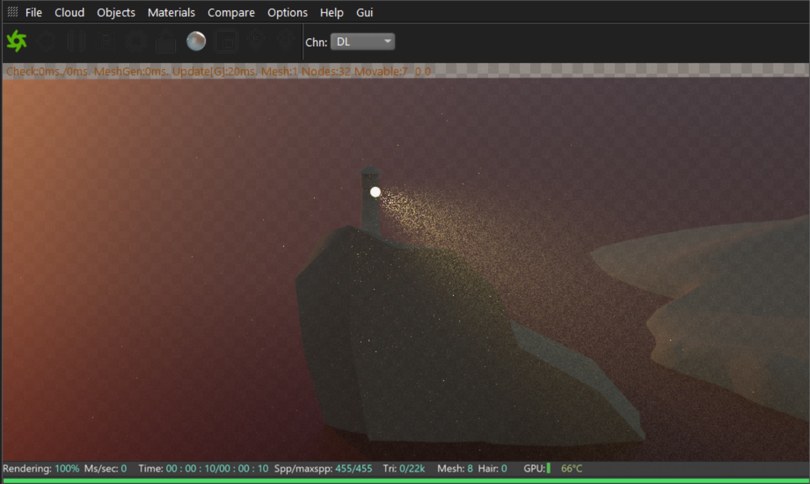

I've just added a Medium to my Octane Daylight tag and it's working thanks to this post. But it seems like the Medium is now making a reflective surface reflect the alpha checkered background in my Live Viewer? It doesn't render like this, and if I turn off alpha channel the live viewer returns to normal. Does anyone know how I can get the checkerboard to stop appearing when the Scattering Medium is added?

Postby aaronheth » Sat Dec 30, 2017 6:23 pm
aaronheth Sat Dec 30, 2017 6:23 pm
Here is the scene with the fog medium still on the Octane Daylight with NO Alpha channel:

Re: Atmospheric fog ?
Postby aaronheth » Sat Dec 30, 2017 6:26 pm
aaronheth Sat Dec 30, 2017 6:26 pm
Also for reference, here is the scene with the Alpha Channel but no fog.
Maybe I am misunderstanding how this works, I am just curious why the fog medium makes the checkerboard alpha material show up in reflections in the Live Viewer?

Postby aoktar » Sun Dec 31, 2017 12:36 pm
aoktar Sun Dec 31, 2017 12:36 pm
There's an option to hide alpha checkerboard. LV options menu, show alpha
