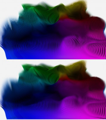

Damn, it isn´t so simple to include strand motion blur.
Thought i can use the strand velocity, but it´s only a copy from the point from which the strand is generated.
Means, each strand point will have the same velocity. So i think i have to calculate the velocity by myself over the strand positions on different frames.
I hope that my thoughts are right and it will also work if a strand is growing and the strand point count will change over time...

Postby face » Thu Oct 05, 2017 5:56 pm
face Thu Oct 05, 2017 5:56 pm
Done.
But it isn´t perfect. It´s an Octane problem.
Each strand segment is a single open ended cylinder, so you must also subdivide a deformed strand much more than a strand which has no deform.
This will work for non motion blur strands, but it wouldn work with motion blur, you will ever see some segments.
So my conclusion is, motion blur for strands works, but i wouldn´t use it.

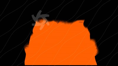

Postby face » Thu Oct 05, 2017 8:51 pm
face Thu Oct 05, 2017 8:51 pm
Object layer map with strands.
Will now update the VDB section to work with the new pointcloud structure...
http://vimeo.com/user2509578

I remember I had to compute and set "StrandVelocity" myself to get some motion blur in other renderers. That would be ok too (maybe even better because it's more controllable for the user).
Overall I think strand motion blur isn't super important as long as motion blur on the whole point cloud object with strands works ok.
