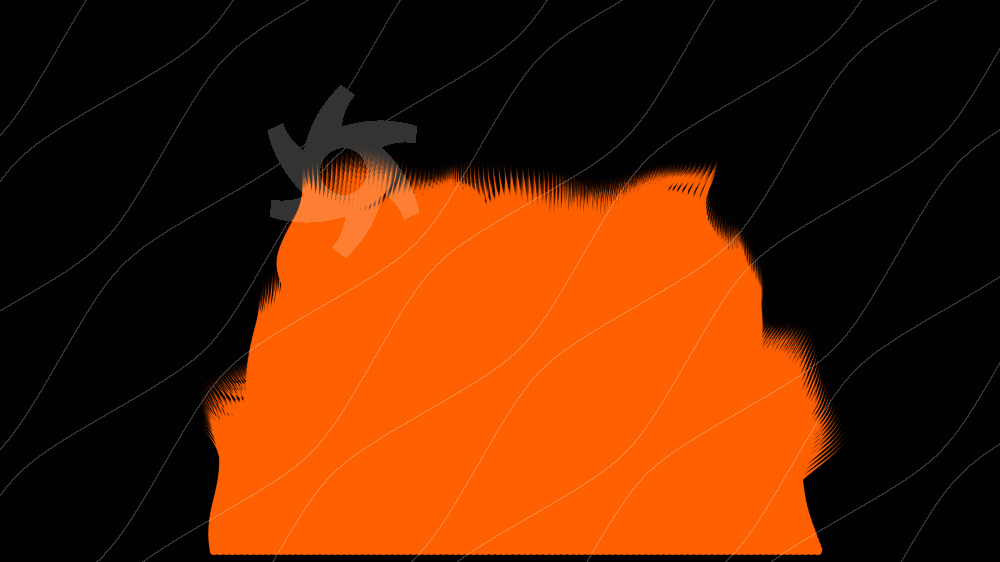

Object layer map with strands.
Will now update the VDB section to work with the new pointcloud structure...
