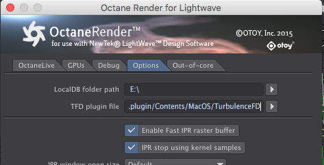

I can confirm that TFD 1427 works fine with the upcoming LightWave plugin build that I'll release later this week. Be aware that in the Octane plugin options panel, the path to the TFD plugin must be the full path to the "TurbulenceFD" library available inside the TFD .plugin container.

The current production build has been updated, including the new TFD on OSX support:
viewtopic.php?f=36&t=61820&start=10

Juanjo,
I'm sorry it has taken me so long, but I wanted to say thank you for getting this to work.
I had shifted all of my work over to Windows when I ran into this problem, and just today shifted it all back.
Now that this works on OS X I can go back to my older workflow (which I preferred).
MANY, MANY THANKS! :D :mrgreen: :lol:
