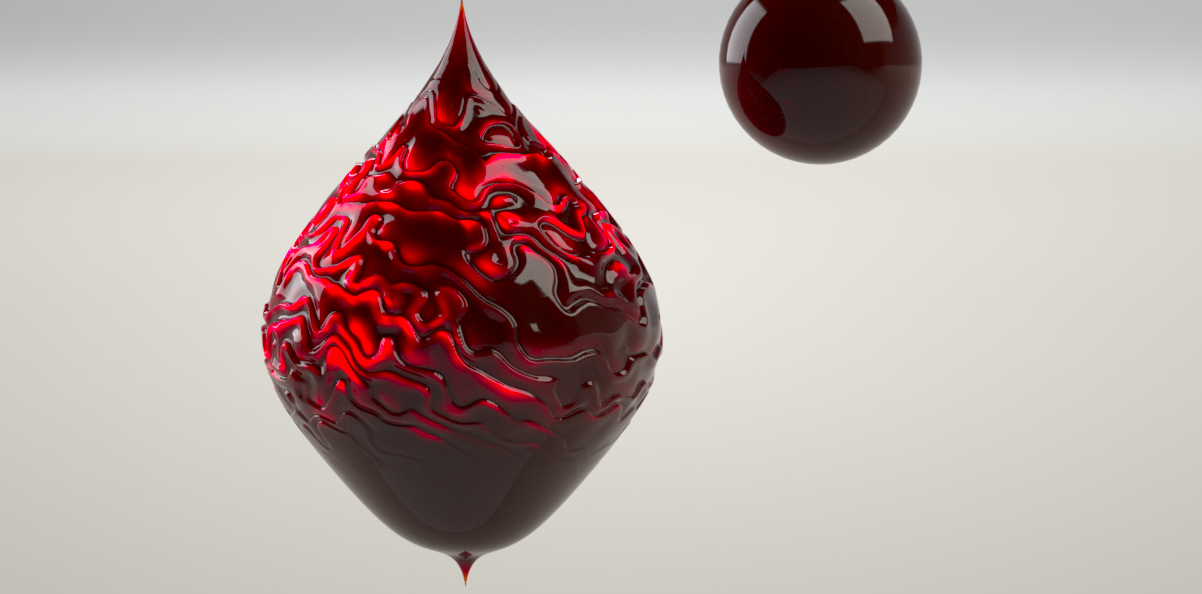

It would be great to have a subsurface multiplier like in Modo to help creating cool glowing effects (or like Light multiplier in VRAY). With Octane SSS many times I find I can't reach the intensity I want for the type of artwork I do. See image below.

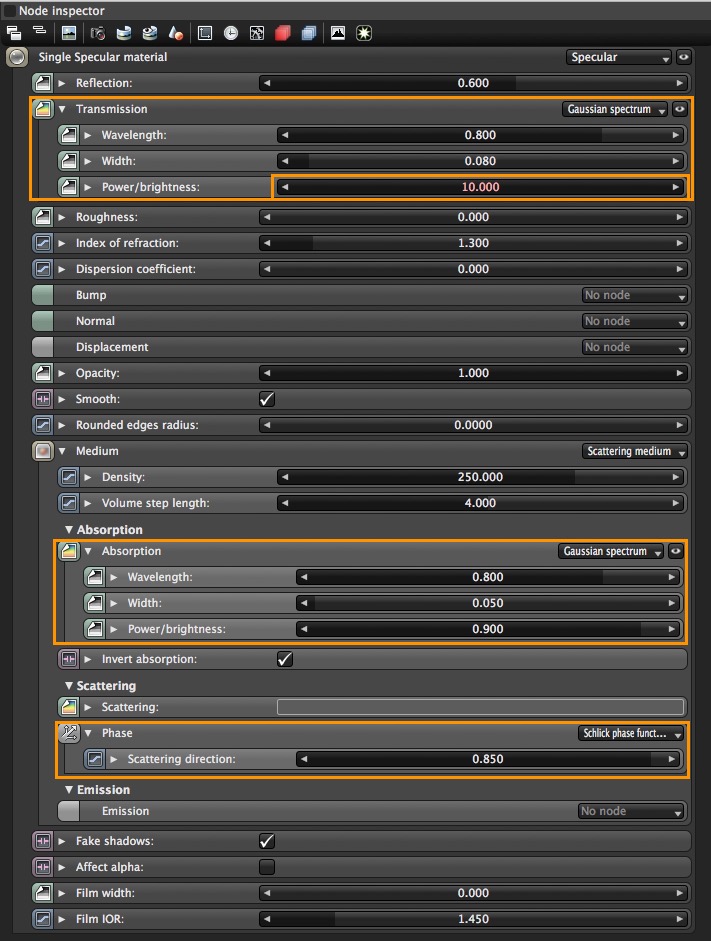

Hi jerzer,
finally I have found the time to look at your scene.
Here is my version with only one Specular material instead of a mix material.
If you use a Gausssian spectrum node, instead of an RGB node, you can easily use a value greater than 1 in the power pin. Playing with the Phase value, helps to reduce the transition between the colors:
SSS-b2.orbx.zip
(19.9 MiB) Downloaded 340 times
In general, with Specular material and SSS, better to switch to PMC kernel, instead of Path Tracing.
