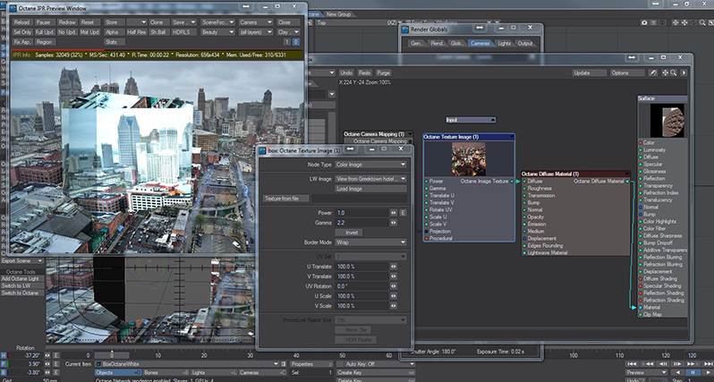

Thanks for the reply, though I am not sure that it is helping.
here is a screen shot of what I am working with and the visual feedback I am seeing.
Look at how the BG image is larger than the visual output, and appears stretched in the X axis.

Postby Alteris3D » Thu May 11, 2017 9:18 pm
Alteris3D Thu May 11, 2017 9:18 pm
How come your diffuse material output is not connected to anything?

Postby Bookmansblues » Thu May 11, 2017 9:24 pm
Bookmansblues Thu May 11, 2017 9:24 pm
Alteris3D wrote:How come your diffuse material output is not connected to anything?
it is so I can switch the material depending on which compositing pass I am working on.
The diffuse material is matte so I can get the lighting off the surface of the water reflected off the 3D objects in the scene.
The way the material is set up now it is just for getting the reflections off the 3D objects in the scene in the water surface.
Hence question #4, I want to be able to capture those reflections without picking up the reflections from the environment, since in the footage those reflections already exist, and adding them again will make them unrealistically brighter.

Postby Alteris3D » Thu May 11, 2017 9:48 pm
Alteris3D Thu May 11, 2017 9:48 pm
OK, maybe I'm not being much of a help. I don't see why your background image is stretched, the camera mapping node works as I expect it to. As for your water surface reflections, why not render that without the environment, wouldn't that give you just the spaceship reflections on the water?

Postby juanjgon » Thu May 11, 2017 10:57 pm
juanjgon Thu May 11, 2017 10:57 pm
I must check it again, but I remember a limitation related to the cameras to be used in the camera projection must have the same resolution aspect ratio that the main camera. Perhaps this is your problem. If you want to send me a sample scene with this issue I could test it here.
