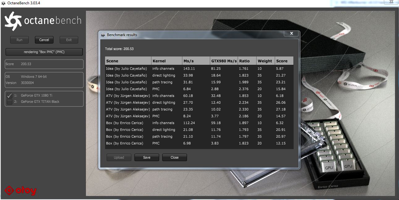

went over 200 in OctaneBench with Founders Edition 1080Ti a day ago & the other Guy pushed over 213 (with the same OC settings). Leaving the copy/pasted text from the post:
Since that will be an interesting topic for a lot of #OctaneRender users "how good #1080Ti actually is?", I will leave You with this print-screen:
200.53 in non official [3.03.4] #OctaneBench on air *
(out-of-the-box, without any tweaks it gives ~170)
EDIT: other are getting up to 213.5 with same settings
link: https://twitter.com/TeddyRockStea…/status/844980642752417792
* with few tweaks:
Core Clock +210 (leading to 2063)
Memory Clock +555 (leading to 5562)
Fan Speed at 100% **
** the reason for later is to keep card as cool as possible (it would work on 75%, but fail on 50%), under full load it went up to 55C. If I slow the fan speed & temperature rise, somewhere between 70-80C card starts to throttle down (even if temperature limit is still set at 84C), lowering it's core clock & eventually fail (meaning that You need to reboot computer in order to run card at all).
Hope that is going to be useful for some of You.

So Tom, what is the highest 980Ti with OC you have seen? I've never OC'd, and may never, but good info to have, for comparison.
