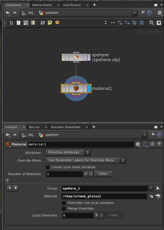

To assign materials to objects from .obj files you need to use the Material SOP node. The .obj files are imported using geometry groups, that currently must be configured using the Material SOP in the Octane plugin.

Thanks for yet another super fast response. Is this documented someplace I've missed btw? Just wondering in case I should read some part of the manual for a few more of such noob questions.

Nope, I think that this workflow is not documented. Anyway, there are a lot of things to update in the docs related to the new 3.0 features, that I hope to add as soon as possible.
