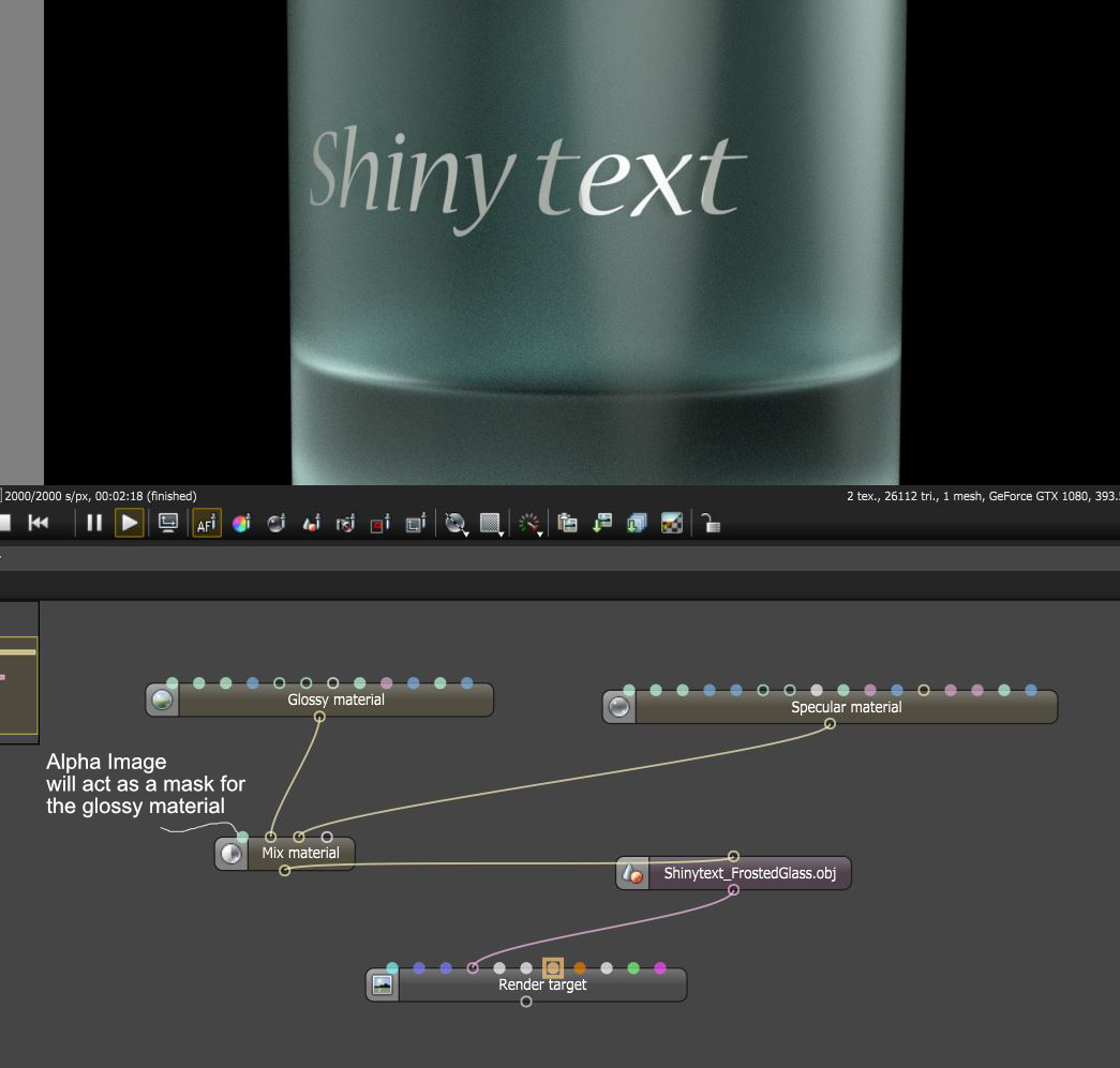

Hi there.
I hope I'm understanding what you are looking for. Here's an example using the standalone but think you can apply the same principle in the plugin. I just recently "figured this out" for myself recently about using "mix material" and separating a different material for one element from another. Basically like adding a label/text onto a frosted bottle.
See pics showing the Octane viewport and nodes. Note the Mix Material that is the primary texture node to the obj. That mix really consists of the glossy (metallic type) and the specular (for the frosted glass). The "amount" is actually an alpha image. The black text will create a mask for the glossy type. The mix node shows some circled areas in red that are pretty important. I also showed you what the basic image looks like that is used for the "amount".
Of course, this is the way I make it work...might be a different/better way!
Hope this helps.
