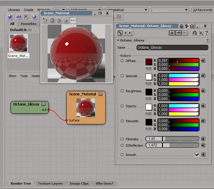

1- I changed preferences for Octane renderer engine.
2- Just created scene with a simple sphere and a new material from Material Manager
3 - The only things I can change are the colour and image map --> Reflection/Glossy for example are not viewed in the shaderball view

wireframex wrote:1- I changed preferences for Octane renderer engine.
I have made it and this is the result:
http://vimeo.com/user2509578

Postby wireframex » Wed Apr 13, 2016 6:01 am
wireframex Wed Apr 13, 2016 6:01 am
I don't have this result at all.
I will send you my result this evening.

Postby face » Wed Apr 13, 2016 7:18 am
face Wed Apr 13, 2016 7:18 am
wireframex wrote:I don't have this result at all.
Phil
Can you attach a scene file, you can send it as pm?
I can also make a build wich will save the shaderball as an ocs file, which you can open in Octane standalone, to see how it looks.
For this you must say me a save location because it is hard coded, something like "d:\tree\"
You can also take a look into the Octane log, there should be some errors if some connections or parameters are invalid.

Postby wireframex » Wed Apr 13, 2016 5:12 pm
wireframex Wed Apr 13, 2016 5:12 pm
All is ok
Found the pb in shaderball preference ... :?
Sorry
Phil
