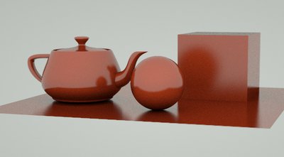

ok well I've downloaded your second 12345.obj and it loads fine here.
It is about 100x bigger than real life though (as opened in Blender) and I had to rotate and zoom the view in Octane to find it initially.
Instead try setting the File>OBJ mesh import preferences>Scale to cm to metres first and give the viewport a wiggle sideways after you have imported it - for some reason it wasnt immediately visible in the white background otherwise. It will be black having no material. See attach pic of your scene with red glossy applied.
BTW you load your .obj by right clicking in the Graph Editor area and choosing Add>objects>mesh.
Your drivers should be working fine since you cleaned and reinstalled.
If not can you describe the specific issue/warning please.
Does Octane actually open ok now?
You are using the latest demo version of Octane?
