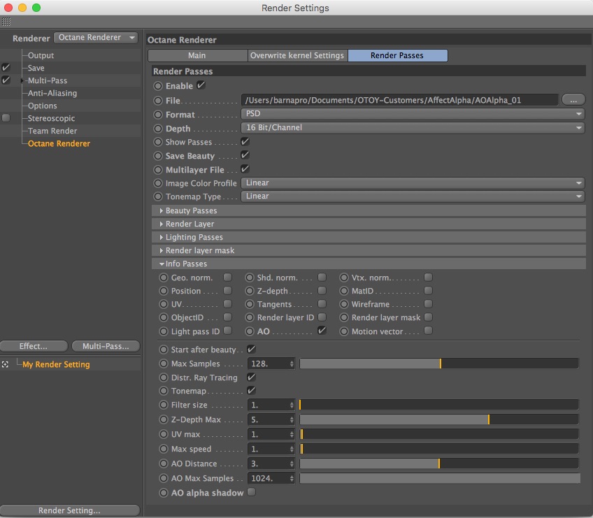

Postby bepeg4d » Wed Dec 16, 2015 10:35 am
bepeg4d Wed Dec 16, 2015 10:35 am
actually there are no issues if you render the ao channel alone, but there are some issues if you do a multipass render, unless you save the final result in PSD format.
please try with this simple scene, there is a Beaty pass + AO pass with alpha channel:
AOAlpha.c4d.zip
(60.21 KiB) Downloaded 252 times
ciao beppe

Postby bertritude73 » Thu Dec 17, 2015 7:04 am
bertritude73 Thu Dec 17, 2015 7:04 am
thanks for your help, it worked with save as PSD file. I've a layer with the alpha :-)
Bertrand
