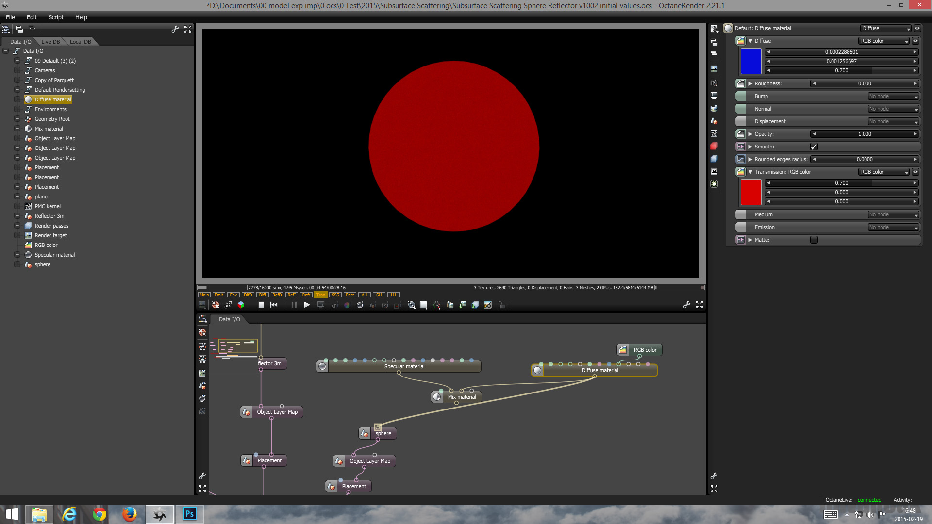

If you take a Diffuse material with Transmission you get:
Diffuse Material with Transmission - Beauty Pass
As I would expect the transmission is output in the Transmission pass:
Diffuse Material with Transmission - Transmission Pass

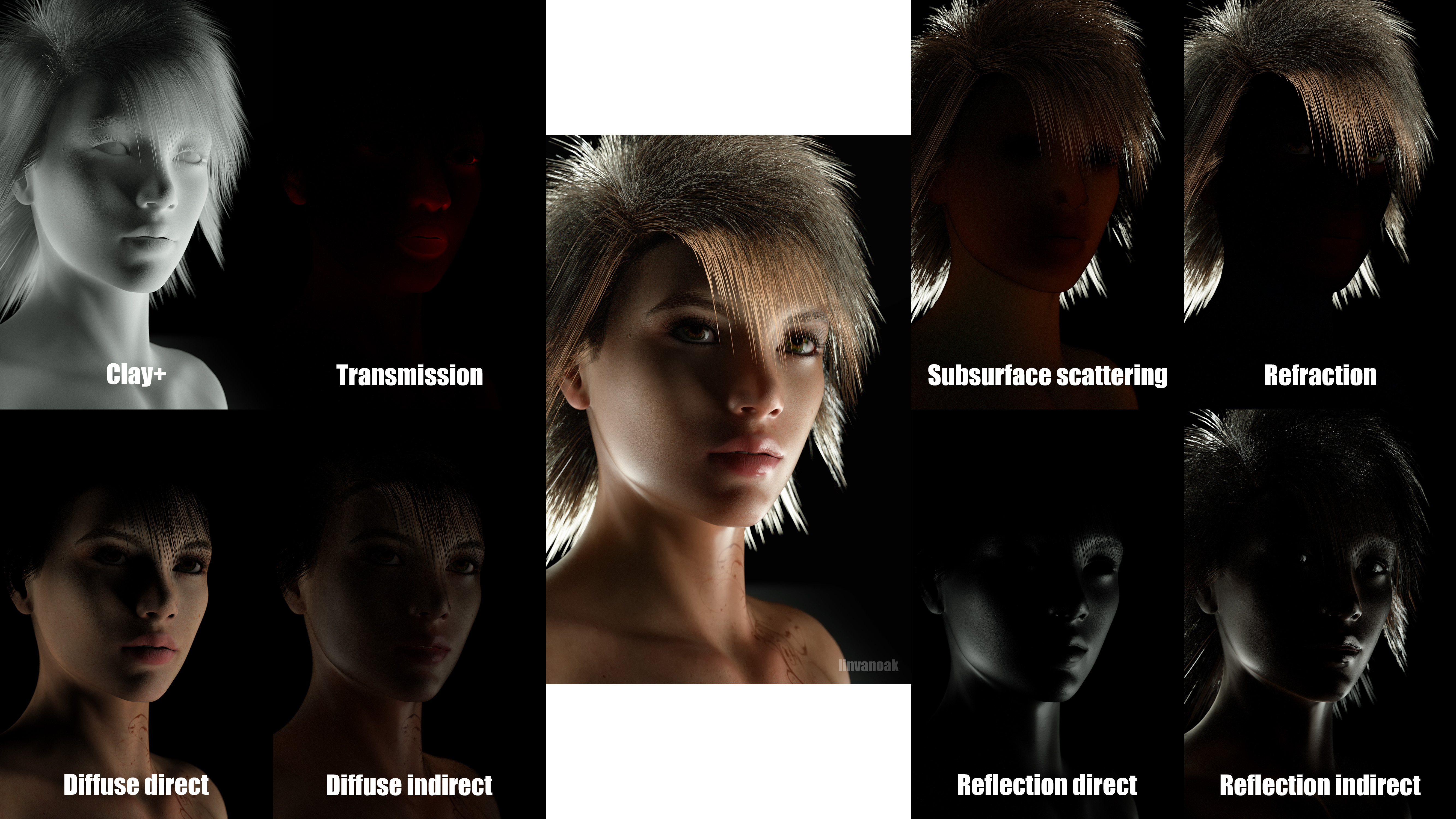

Update / Edit:
In the meantime I updated the shaders used in my experimental portrait project.
Now the different passes look like this:
Izarra v1015 OctaneRender passes
In any case I would find it interesting if more people would start to share render passes to get a better understanding how each layer contributes to the final image.
