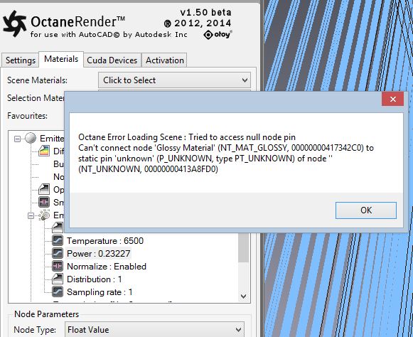

Hi Paul,
Still I get errors when opening the Octan erender viewport.
Please see attached snapshots. This I think is material node connection problem...
Iviz3d
Would it be possible to send that scene to me pls?

Hi Paul,
Its an old scene with old materials and setting, no more issue when I replaced the old glossy material with new glossy material.
