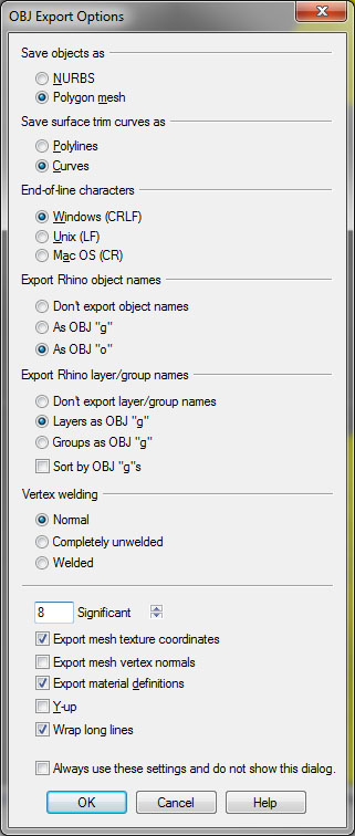

For coming out of Rhino, clearing "Export mesh vertex normals" seems to make happy OBJs. This dialog is from Rhino 5 beta, Rhino 4 does not have this as an OBJ export option.

SamPage wrote:For coming out of Rhino, clearing "Export mesh vertex normals" seems to make happy OBJs. This dialog is from Rhino 5 beta, Rhino 4 does not have this as an OBJ export option.
2.2 will allow you to use export vertex normals and have much better quality rendering.
can you try with the export mesh vertex normals enabled, and using the new 2.2 RC1 i just posted ?
Seems to be working very well, thank you :)
