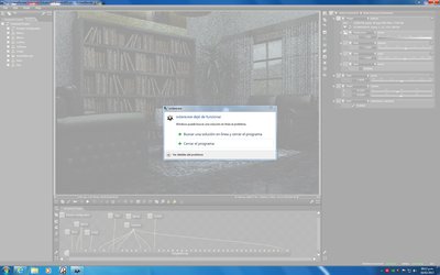

merid888 wrote:i'm using octane standalone and have a error with hdri, maybe som bug for hdri ? the image only have 3.5 mb
