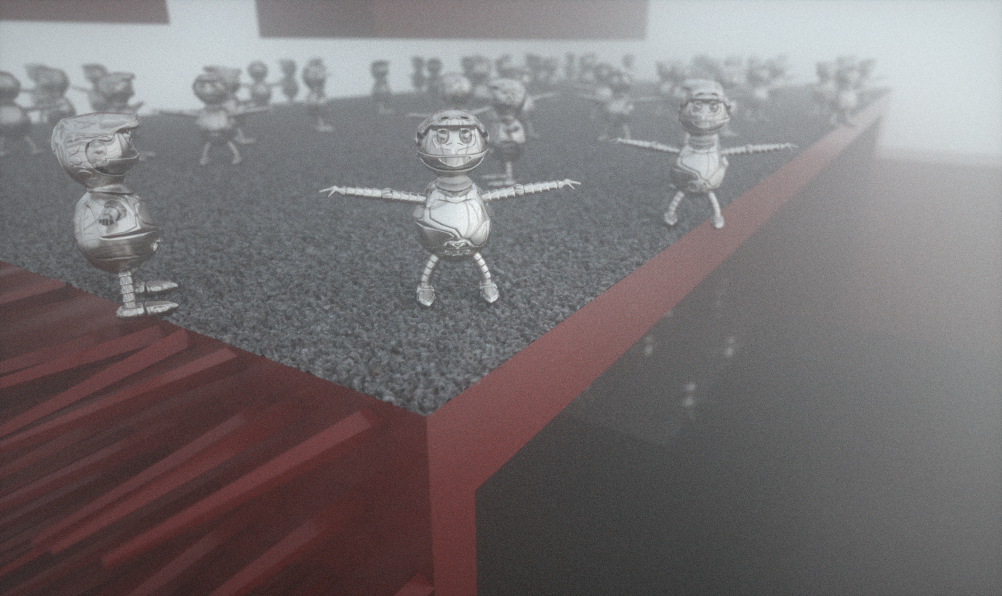

Have u seen this one?
https://inlifethrill.com/fog-octanerender-cinema-4d/
https://lesterbanks.com/2018/02/everyth ... 4d-octane/
PS: Sometimes I have to tweak "Coherent ratio" to get fog working in the "Environment" tab in the SU plug-in (strange).....
PS: fog working in SU ;)
