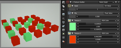

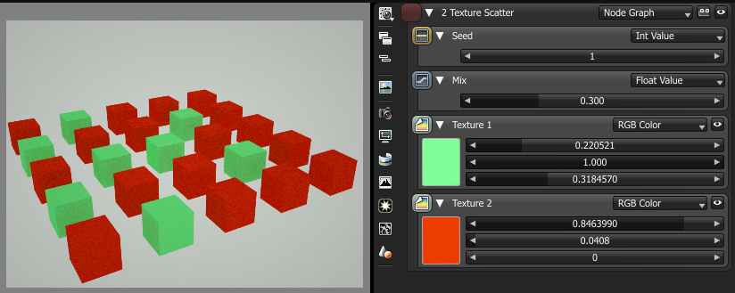

That would be the way I would do it:
2_color_scatter.orbx
(18.75 KiB) Downloaded 191 times

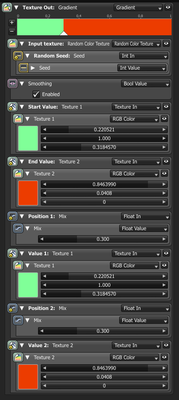

Until we have the ability to switch off interpolation in the gradient texture you can achieve a similar result by adding two gradient control points with the same position:
This is how the gradient node looks like:

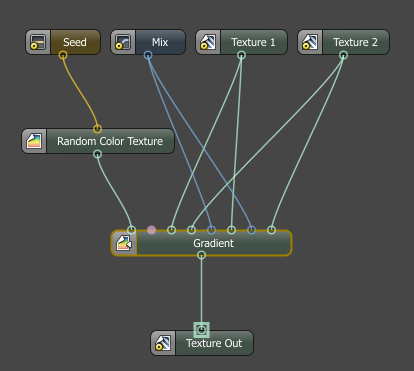

Packed everything together into a node graph you get a nice and easy to use interface:
I hope that helps.
