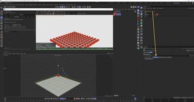

Hello,
I have Object Scatter objects and under it there are 3 cubes.
Scatter object uses surface distribution. But I see 3 source cube on the scene too. I need to hide them from render. How can I do that?
thank you
Re: How can I hide object scatter's source objects?
Posted: Mon Dec 13, 2021 8:58 am
by bepeg4d
you could hide the objects to scatter in a Null with red traffic-lights, then use an instance of the objects as source for the Octane Scatter:
Note that the Instance object must be set to Instance mode, Render Instance or Multi Instance modes are not working in this case.
